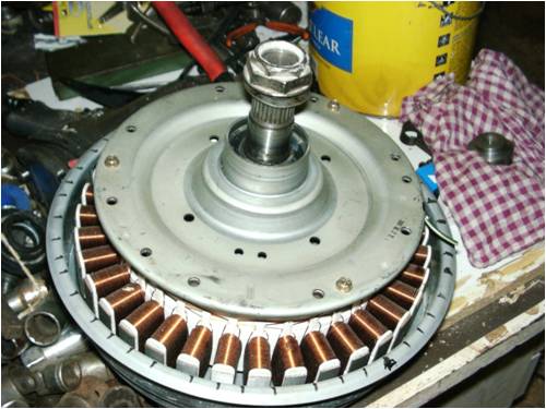

I WOULD SUGGEST YOU CONTACT PHILLM ON THE FORUM TO GET YOU GOING AS HE HAS BASIC MILLS AND BLADES FOR DIY.
MY NEXT PROJECT IS A LG MOTOR CONVERSION SO THAT IS WORTH A LOOK
