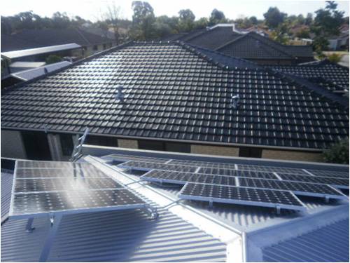

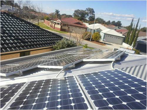

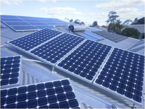

its done and complete, signed off and all fully legit ( at last )
Here is some more to drool over and I've celebrated with more than a few beers with the sparkie who was a CHAMP.
Some Quotes " Couldnt have done it better myself, geez thats a great idea, WOW whats this, thats fantastic, Wish they guys I normally work with were this good. Nothing I want to change"
All stuff I love to hear!
here's some pics

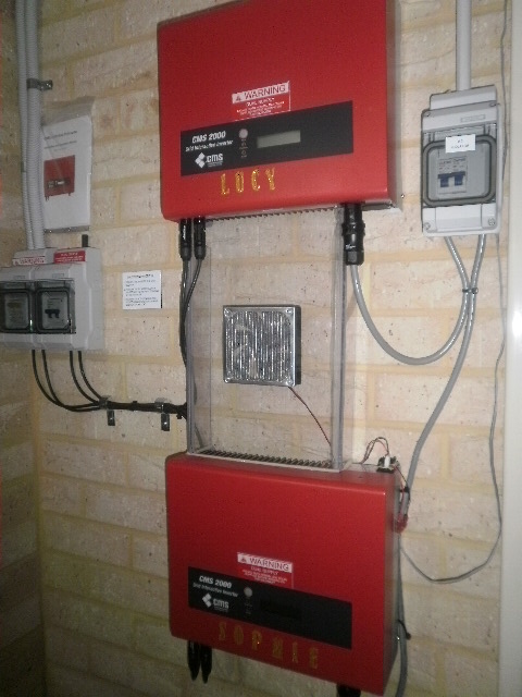

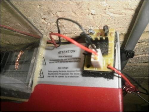

INverter cooler -12V PC fan, scrap PVC sheet, grille, 12V fan speed controller uses heatsink temp to vary speed, switchmode power supply from dud battery charger.

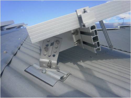

Arrid mounting feet (very cool)

Karl, I think you might need to rent the next doors roof, yours if full. Looks very well put together. Hope the weather there has been better then here, for the past week fog till lunch time then overcast for the rest of the day.
Anyway looks good

plenty of space remaining!
I have NW facing roof remaining good for another 14 panels, after that it gets interesting.
FIT limit over here is 5KW of inverters and I currently have 4KW.
however, I havent found any 1KW inverters listed on the market.
would like a 1KW rated inverter with max delivery peak of 1.3-1.5KW
and on it I'd run another 1.5KW (call it another 9 panels)
5 would fit nicely on the NW facing roof out the front and another 4 panels just extending down towards the gutter from the main NW facing array.
all a bit of a moot point as I'm out of money!
