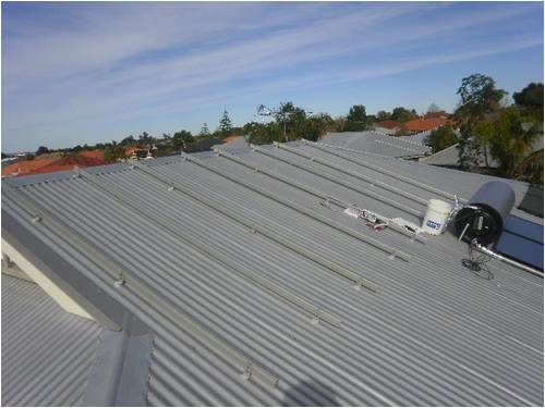

Stage 2 and three pics
NW facing roof, will be 14 panels

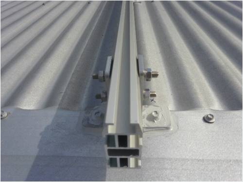

Bulletproof, double feet, top and bottom

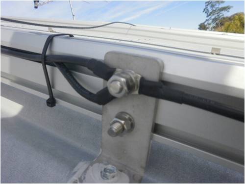

Frame earths

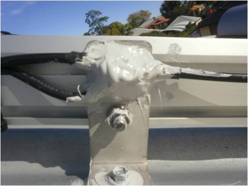

Frame earths sealed to prevent moisture ingress (boeing spec!)

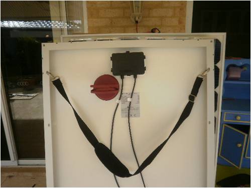

Method of moving panels to the roof without breaking them
Laptop strap and suction cup thing

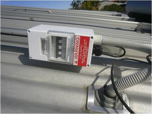

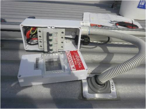

Circuit breaker box 2x10A breakers one for each string, decktite for
roof penetration.
Breaker box with cover in place

Posted: 03:19pm 20 Jun 2010
It dont look as though the feet on your panel tracks are made with correct spacing to match fastening to the top of the iron flutes on both sides, and i would find it very strange to fix through anywhere other than on the top of each corrogated flute.
It might be the camera angle, other wise its a poor design in the footings.

KarlJ
Joined: 19/05/2008
Posts: 1178
Posted: 01:37am 22 Jun 2010
Camera angle, feet line up perfectly with the tops of the ridges

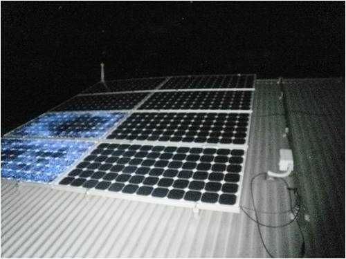

STAGE 4 complete!!

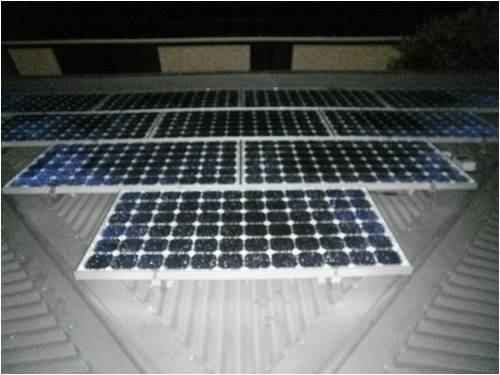

Stage 5 Started, got 9/10 panels up on the north facing last night (in the dark!)
and will get the remaining 15 panels up tonight (weather permitting).
then the following night will be wiring back to the now otherwise completed roof breaker boxes, then commissioning on Friday by the sparkie.

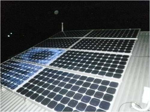

Posted: 12:03pm 22 Jun 2010

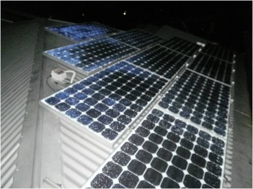

Stage 5 almost complete
Nth facing array complete, 1.85KW 10 panels
NW facing 8/14 panels up, took these in the dark hence the blue tinge on the ones that were wet...
Fitting panels in the dark and in the rain sucks!

Why do you need that bloody great earth strap along the rails?
The rails are metal the screws are metal the roof is metal and the roof is connected to a lightning rod/earth one would hope.
I am assuming you put insulators in between the rails and the galv roof to stop corrosion, silicon sealant over the bolts is good I did that too.
I used special insulator ETSA plastic which I got for nothing but I could have used PVC pipe after thinking about it. Just use a 1inch hole saw through the pipe and use the cutout for the insulator even has the hole in it for you and is shaped for the top of the corrugation
Arr the rail has stopped out to Finnish putting the gutter guard up
KarlJ
Joined: 19/05/2008
Posts: 1178
Posted: 11:25am 26 Jun 2010
I'll reply in great detail here for a number of reasons....
The earth cable I used was just normal solar spec cable -I had it left over
as I bought sufficient extension leads to avoid cutting the leads on the panels (ease of re-configuring and/or expansion later.
Why earth the frames...
Transformerless inverters have AC with respect to ground on the inverter inputs.
ie not galvanically isolated.
what does this mean -a capacitive coupling is developed with the frames causing them to be live with ~110VAC.
As it happens, the insulation between feet and roof is poor thus they dont in fact develop the voltage as other TL systems I have seen.
So why bother you ask - those joints that leak the voltage away will cause corrosion and if you can take it away more easily to earth via a proper earth then this will slow down or stop any electrolytic corrosion occurring.
They are connected at the roof mounted breaker box to the 2.5mm2 earth wire.
