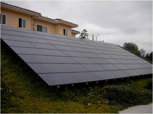

I went to a friend's house today in a neighboring town, Vista, California. Turns out my friend (much older than myself) is in God's waiting room; very ill, etc.

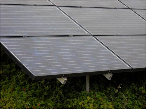

I snapped a few shots of his solar application. This thing is as big as a backyard swimming pool! It sits at the south side of his house (mansion!) at a tilt of our latitude (38.5 degrees I think) and makes electricity whenever the sun's not blocked by clouds.
There are 9 columns of 8 panels each, making 72 panels, which are
each about 3 feet x 4 feet!

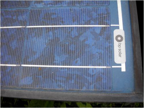

Here's just one of the panels in the lower left-hand corner of the array.
That little tag says BP Solar. I'm guessing that stands for British Petroleum,
but it's just a guess.

Those panels look like BP Solar 80 watt units and with 72 of them that's a serious solar array
Should do around 25kw a day average if its on a mppt grid connect system. He should be getting a good credit on that though if its tax credits and he isn't paying any tax then it may be nothing.

  VK4AYQ said  Those panels look like BP Solar 80 watt units and with 72 of them that's a serious solar array
Can we please pay a little more attention to detail? There are a LOT of people read articles like this who are already confused enough between watts, kilowatts, volt-amps kilovolt-amps, watt-hours, kilowatt-hours etc. Using the wrong terms in these posts is only making things that much worse because people see it written and "learn" their wrong terms as right, teaching others as they go.
72 modules of 80W each is nominally 5.7 KW peak output. That is, instantaneous power output.
If there were 5 hours of full sun that would produce 28 kilowatt-hours (kWh). (Of course, the sun doesn't shine square on to them all the time, so there will be more hours of sun, some more oblique and making less power than others). In 8 "daylight" hours, your figure is likely close to the money - but the units are not.
