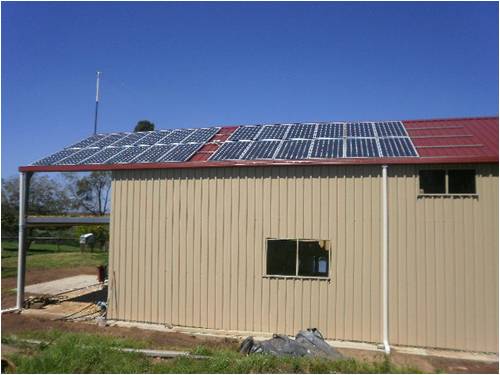

FYI this is Dads 4.26KW system, it runs 2 x 2.2KW CMS inverters.
they seem ok enough bells and whistles to keep us amused.
Incidentally he ended up with 12x 180W panels on the left
and 12x 175 W panels on the right, same problem everyone is having at the moment, cant get the gear they want but will take whatever they can get.
These are solarfun panels which came with a LLoyds of London underwritten 25 year 80% output guarantee.
Extra space on the far right is for me to add a couple of panels to the PVE 1200, might as well max it out too!Edited by KarlJ 2010-03-01
