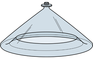

Not sure I agree with the better. But it would sure be a lot more complicated than this:
http://www.watercone.com/product.html

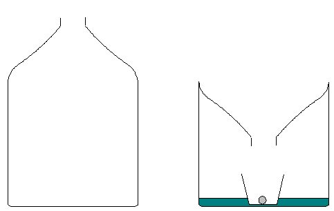

Still haven't figured out a decent way to make my own water cone (and buying is cheating), I very much like the elegance of that design. Simple and functional. Any fool can complicate matters....

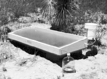

For more water, you can't beat the simplicity of something like this:
http://www.txses.org/epsea/watersolar/purification

I came across your discussion while looking for ideas on how to produce irrigation water for my fruit trees from brackish well water. Very interesting indeed. 2 questions that I would like to pose:
1. In East Africa we pretty much have to use readily available materials and adapt them. We have large 5000 litre black plastic tanks that could act as heat absorbers and might serve as the 'dome' for a system such as you describe but without the pressures described.
2. Another resource we have are the large clear plastic 9 litre water containers - seeing the watercone idea, I wondered whether it might not be possible to adapt these 9 litre containers - particularly in multiple banks of them - to act as a kind of watercone factory to provide drinking water for our coastal dwellers. At present the locals have to travel by foot or bike very long distances to collect potable water in gallon containers and anything like a watercone, even if not so efficient, might do the trick. Any ideas?
