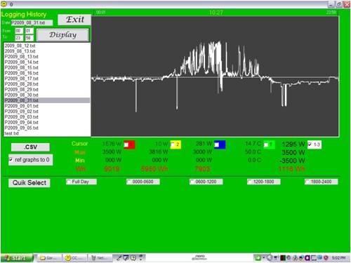

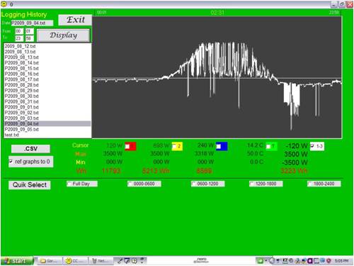

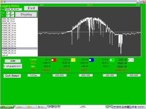

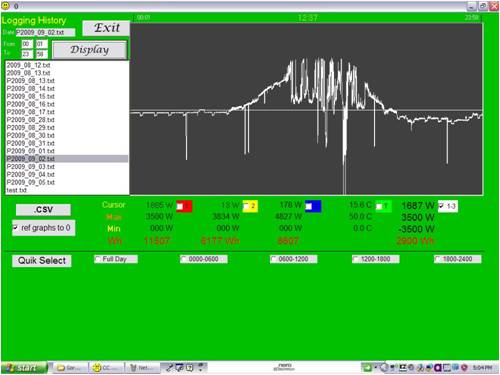

I have compiled a weeks logging of net energy use for an all electric home. This is warts and all data.
Above the horizontal line is NET Export, and below the line is NET Import. There are numbers in red that are the kWhr readings for the day.
First day is 29/08/09.
An interesting point is that on one day, the evening cooking session amounted to a maximum of 2.5kWhr. approx 50c.
on one day, the solar RE amounted to 14.9kWhr.
The effect of clouds on Solar RE harvest is quite clear as well.
The Base load of the house is approx 190W, and this is attributed to the 4 laptops that are logging data presently. In will be investigating an Intel Atom PC, for all logging soon. My intention is to allow real time viewing of all my data through the internet. Must talk to Gizmo!!
Most solar installs will be like this, with a fair proportion of Solar RE exported.
The hardware tools to get the data I presented are OFF the shelf, with my own modified software. These will work on any system up to 100A 240VAC, 3 sensors.

The program is plug and play with the Current Cost meter. I would normally tailor the software, to the logging requirements.
For instance, I measure SolarRE, Total House loads, and Off-Peak hot water loading. I calculate Net Import/Export.
On another app, I set up measuring of a solar bank #1, solar/wind bank #2, and house loading. Both solar systems are the same, so wind can be calculated by difference, and total RE by sum. The net import/export can also be calculated.
I have incorporated scaling into the 2 plug in channels, so Centimeter sensors can be used. The comm port once established can be set within the program, without needing to manually edit the config file. There is presently a large data window displaying the RAW data string, that I still have to try and hide. The data for each channel and the calculated values are displayed on this window. There are logging start/stop buttons, and a setup button, and a graphing window button. The graphing window has Whr totals for the logging interval of each channel and for calculated data. There are preset time buttons. I am looking at a last 10minute logging button for the latest logging trend.
I have only written code for people I know or have met. This is not commercial software, even though the hardware is. The modded software I have made for others has required some personal explanations, as I am not real good with documentation. If you saw how my app works, you may wish to try it. The program is continually being revised, so I could provide an executable of the current app.
