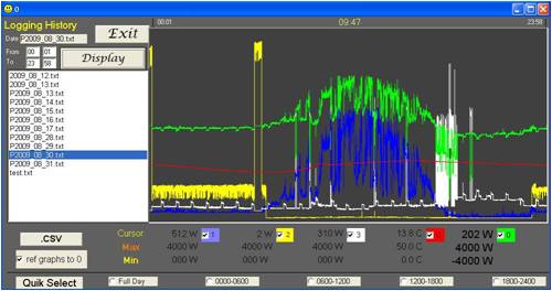

The web cam seems a little tedious, and $800 for Fronius logger, is over the top.
You could consider the CurrentCost meter, sold through Jaycar, for around $200, +$20 for additional clamp meters, up to 3 total. My VBapp program takes the data from the meter and produces daily logs.
here is a sample log from yesterday.
There are 5 graphs, solar RE produced[what the Foronius logger might give], Household power consumption, OFF PEAK heating, outside temperature, and calc NET household import/export.
You can easily see fridge/TV/computer/etc loadings and the effects of clouds on the solar RE.
These units don't require mods to any household wiring, as they use clamp type sensors.
The software available from Current Cost website does not offer the recordings that I have, but only totals and history logging. The live feed option is difficult to use for other purposes.
I am still working on my VBapp but I may make something available if there is enough interest.
