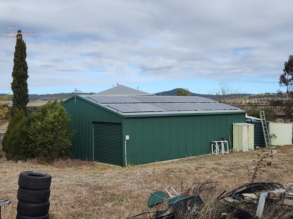

To provide some extra amps on overcast days I added another 8 panels to my 20. Picked up the same size and wattage panel, for free, just got to know the right person and second hand solar panels are almost given away here in Australia. On the shed roof.
So that gives me 5320 watts potential, or 106 amps. Thats just to much for the long life on my controller. As these extra panels are really only needed for overcast days, I built a light sensitive switch to only switch these extra panels into circuit when there is cloud cover.

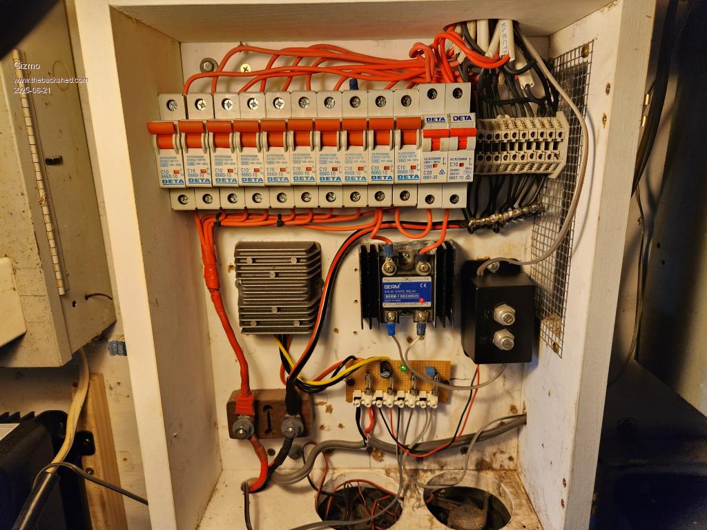

Its uses a LDR mounted on a stick up near the panels, fed into a opamp, with a level and hysteresis adjustment pots. The output drives a SSR. In my solar junction box in the middle row you can see the 48v - 12v power supply ( used for cooling fans on the charge controller, etc ), the SSR and the opamp in a box. I wont show the circuit board, its a real prototyping mess.
A bit of adjustment while some clouds were going over, and it now works great. When its overcast the extra panels give about 6-8 extra amps into the charge controller. A couple days ago it was overcast all day and for the first time my system completed a full charge cycle under those conditions.
As a backup in case the light switch doesn't shut off under full sun ( eg, a bird poops on the sensor ), the extra 8 panels are fed via a 10 amp circuit breaker, this should pop in full sun as the panels can deliver 30 amps.
