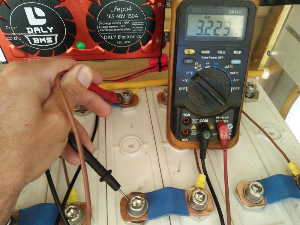

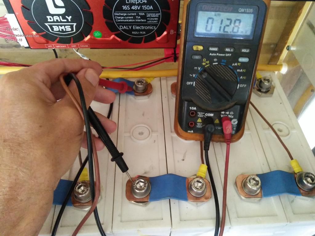

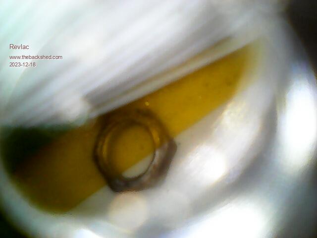

I will just show what was going on and why, the cell would show voltage but would not discharge the voltage would drop to zero (open circuit) when connecting the inverter.
I removed the cell and tried to charge it separately from the others, it would take current for a moment then go open circuit, put a lot of weight on the terminal and it would start again.

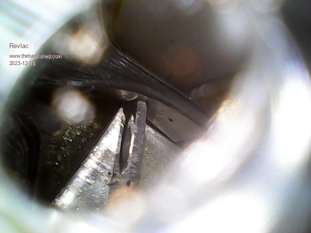

I only recently got hold of a little endoscope camera so I thought I would check inside the cell
Sorry about the small photos, the camera was only 640X480 and had a agle mirror on the end made it worse.

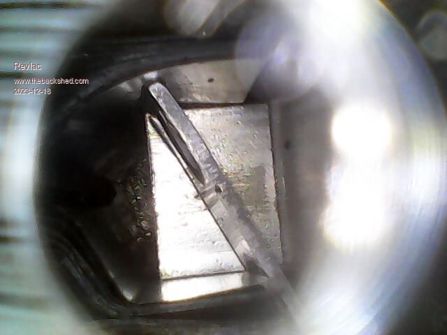

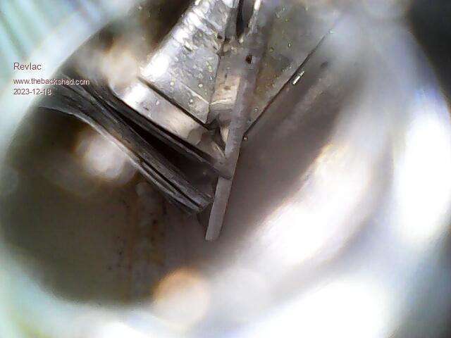

The square aluminium block is the battery terminal going through the plastic top, photos are upside down.
The little plate should be holding the battery plate to the terminal, not sitting there on holiday.
You can see the plates are barely touching the terminal, any wonder it don't F n work.
Hey there's a washer!!!
Oh look, a NUT FFS.

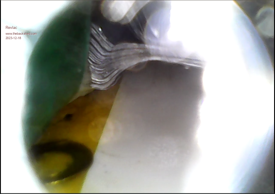

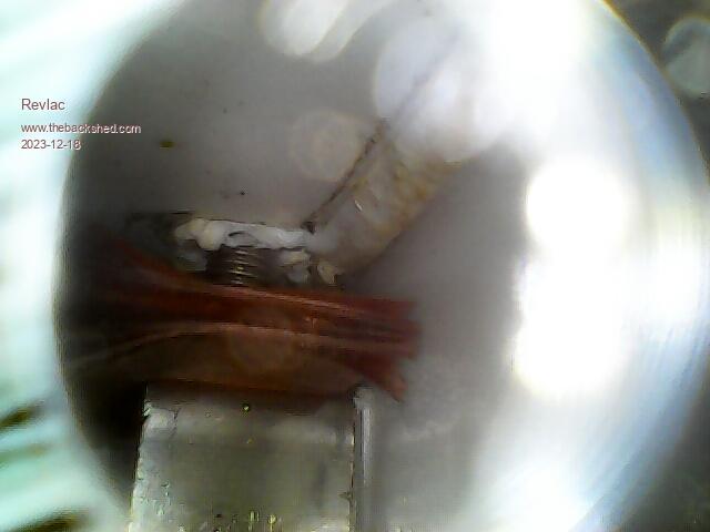

The terminal at the other end with copper plates, can see some threaded rod.

I was trying to work out how they assembled them, the terminals appear to be moulded into the top, the top is welded to the outer case, Perhaps they lowered the plates and the top assembled into the case like it was done with some FLA batteries.

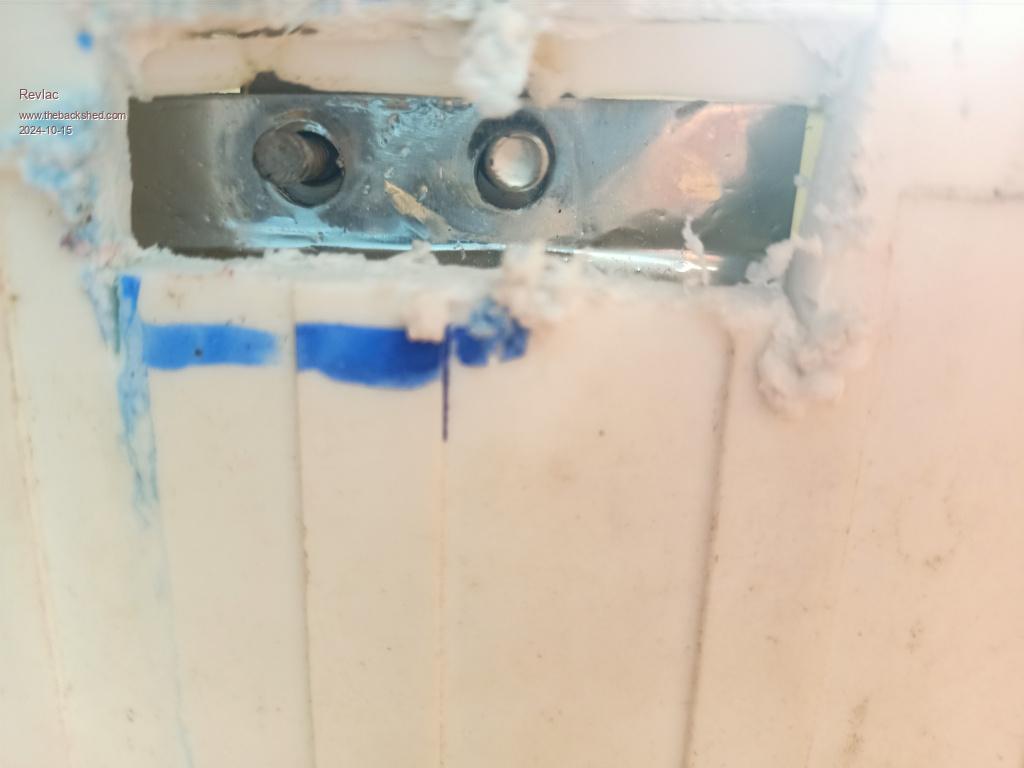

Thought it worth an update, just decided to cut the white cell opened below the terminal just to see whats going on, sort of prompted to do this because of the other white cells in the shed.

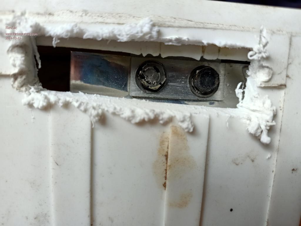

Ok those vibrating saws are handy sometimes, I cut out the area where the positive terminal bolts are located, already new the nuts  and backing plate had fallen off.

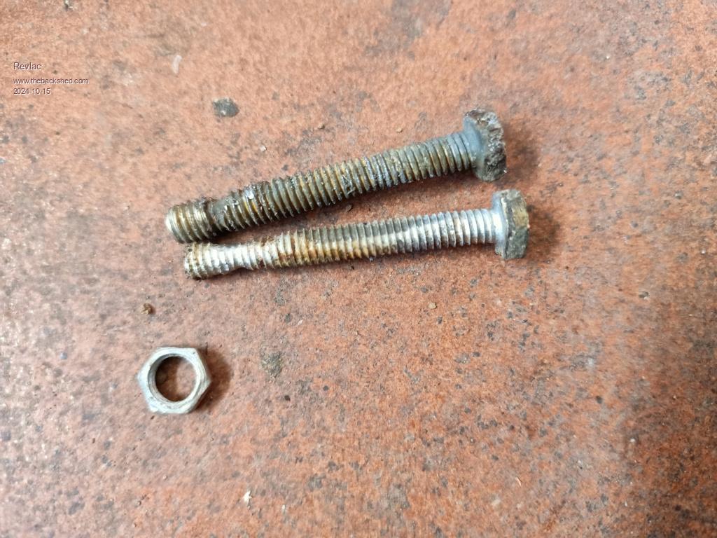

Can see the bolts still in place through the thin aluminium plates, the other side had to be cut opened as well so the bolt heads can be held or removed, I decided to remove them one at a time for inspection, found that they where eaten away for some reason, they were fairly clean SS bolts, retrieved the nut from inside and found it would slide over the bolt threads with out even touching the thread, so it has corroded somehow, perhaps low grade stainless steel as they do stick to a magnet, the other thought it that the batteries might have been stored on there side for some time submerging them in electrolyte and corroding the bolts, these cells are wet with electrolyte so don't tip them over or it will spill out any opened hole...found out.
There was absolutely NO corrosion on the aluminium plates or the copper at the other end, they where as clean as you could ever get.
Anyway just for fun I replaced the bolts tightened them up and glued the plastic case together, checked the voltage and it was just a little lower than last I checked, turns out it was sending some power to parts of the cell that had no contact previously.
Connected the cell to an old charger give it about 40 amps, thats about all I could get from the old charger at low voltage.
So there was almost no resistance at the cell terminals now the voltage barely moved at all, so it would take more.
It looks like it might work now, it might be cheap fix for this cell that was going to be thrown out,  but will leave it sit outside for a while to see if it has any shorts or reaction to being opened.
I wouldn't be surprised if some of the other cells will need new bolts as well, what else is strange is the negative terminal bolts seem to be ok, they bolt through copper plates.

Looking at it again, this might be electrolysis on those bolts.

Aaron, stainless steel (any grade) and aluminium are a *very* bad combination. I know this because for many years I had a sailboat and If I did not insulate these two from each other they would corrode (electrolysis).
Actually, stainless only stays so in the presence of oxygen. If you place it in a sealed space with some kind of electrolyte it will suffer what's called crevice corrosion. The picture of your bolts & nuts show evidence of that.
