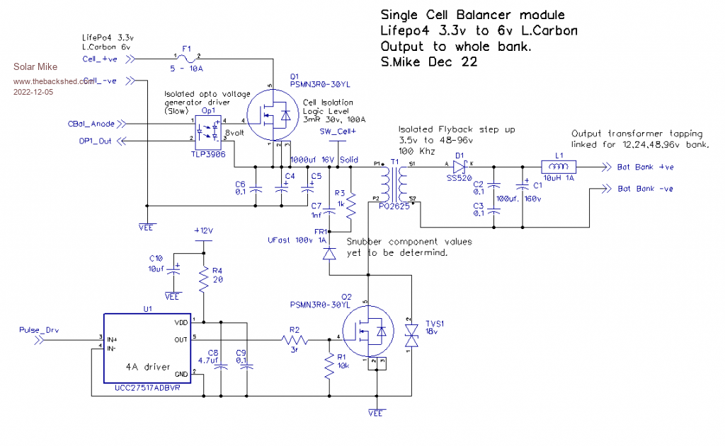

I did look at those cheap multi-cell active transformer balancer units that output to the next cell in line if there is a voltage difference between any two cells > 0.1v. They do work with an amp or so current at larger cell differences, lesser current for closely matched. Again too small for large packs.

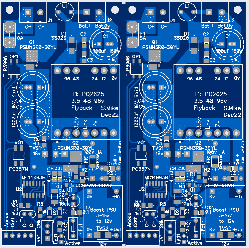

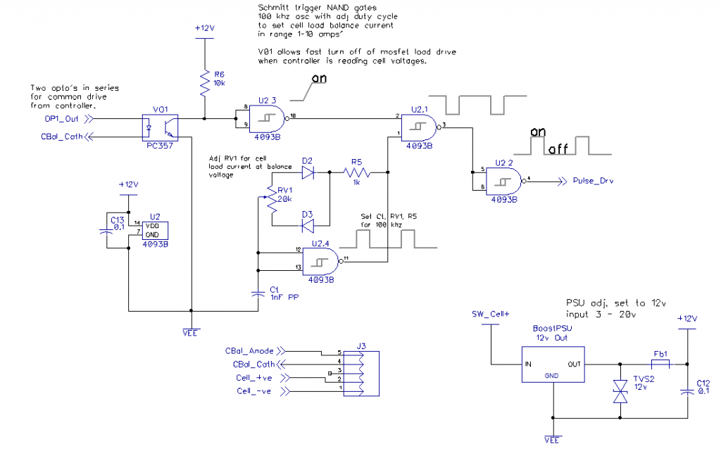

Thought I would have a play with a system that uses an isolated fly-back inverter on each cell that loads the cell up with 5-10 amps and outputs to the whole bank. I have some small ferrite cores here and other components on hand to play with. The test circuit uses a variable duty cycle oscillator at 100 khz to drive the fly-back converter, its duty cycle manually set for the required load current - no feedback.
Difficult to breadboard something like this, good layout is required, so have gone straight to a small pcb 50 x 100mm for testing on a single cell; if it doesn't work, well it was cheap to build.
Because the cell voltages are lower than the min required voltage for mosfet drivers, have used a small thumb sized boost module to up the driver voltage to 12v and run off that.
Here is the schematic:

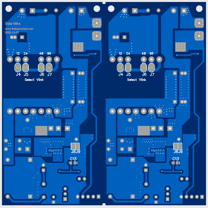

Here is the test pcb, two fit on a 100x100 pcb.
Edit: For anyone whom wants to experiment, here are the gerbers for the pcb, 2 pcs on a 100 x 100mm board. If you get them made 1.2mm thick, can easily score with box cutter both sides and snap in half.

Mike, I like your idea, is their a reason you didn't take an IC like those uc38xx style chips for the flyback?
Then you can have a fixed or maybe variable current, and are not dependable on the load (12V or 48V battery or what ever voltage, because current is fixed).
Would there be a solution to get rid of the extra 12V psu by adding an auxiliary winding?
Or/and adding an extra opto for voltage feedback, if the output was not loaded the output capacitors could blow up.

  nickskethisniks said  Mike, I like your idea, is their a reason you didn't take an IC like those uc38xx style chips for the flyback?
I didn't have any of those generic uc38xx chips on hand, so opted for this design, which may be more complex than it needs to be, I also wanted to totally remove the load off the battery cell when not required. Yes there is no current or voltage feedback which may be detrimental to its operation; time will tell.
I have the pcb's and the ferrite cores + most other bits, waiting on Element14 for the mosfets, they have them in stock but no sign of them after 3 weeks post order.
Just food for thought.
Possibly, those tiny non-isolated boost converter psu's are the size of my thumb nail and will step up from 2.5V to 12V, so will work on 3.3V Lifepo4 and 6V Lead Carbon batteries.
I anticipate possible fireworks getting it working... It will have to always be connected to the main battery pack as a load.
I also have another more simple design using a self oscillating flyback boost mosfet stage, will play with both.
