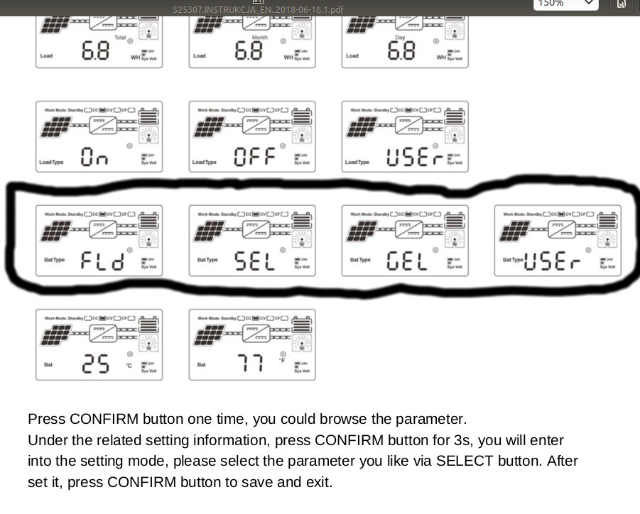

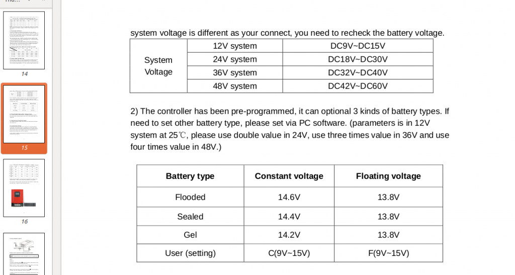

I don't have one of these Chargers, but this is part of a manual.
Hope that helps.

I have the figures worked out, the issue for me is that I don't fully understand the terms they are using.
I am led to believe that LiFePo4 should be charged in 2 stages, first is Constant Current.
As you can see, there is no Constant Current parameter in this menu.
Second stage is Constant Voltage, which I have set to 14.2V. (Battery manufacturer states 14.6V)
Float is not desirable, but cannot be set to zero so I went for a figure that I hope will be harmless at worst.
Boost also cannot be set to zero, so I went for a short burst at the manufacturers recommended charge voltage.
Over VOltage and Under Voltage cannot be zero, so took a wild guess at those.
Under & Over Recovery Voltages I didn't even try to guess because I have no idea at all.
To put things in perspective, this is a single 135AH battery in an occasional use caravan, 4 or five weeks a year average usage. 340W @ 72V solar on the roof.
The parameters that I can set are as follows:
Constant Voltage:   (14.2)
Float Voltage:      (12.6)
Boost Voltage:      (14.6)
Boost Charge Time: (6 min)
Bat. O/voltage:         (14.7)
Bat. O/voltage recovery: (14.2?)
Bat. U/voltage:         (12.5)
Bat. U/voltage recovery: (12.5?)
Max. discharge current: 100A
Maximum charge current: 40A
Cheers,
Phill.
