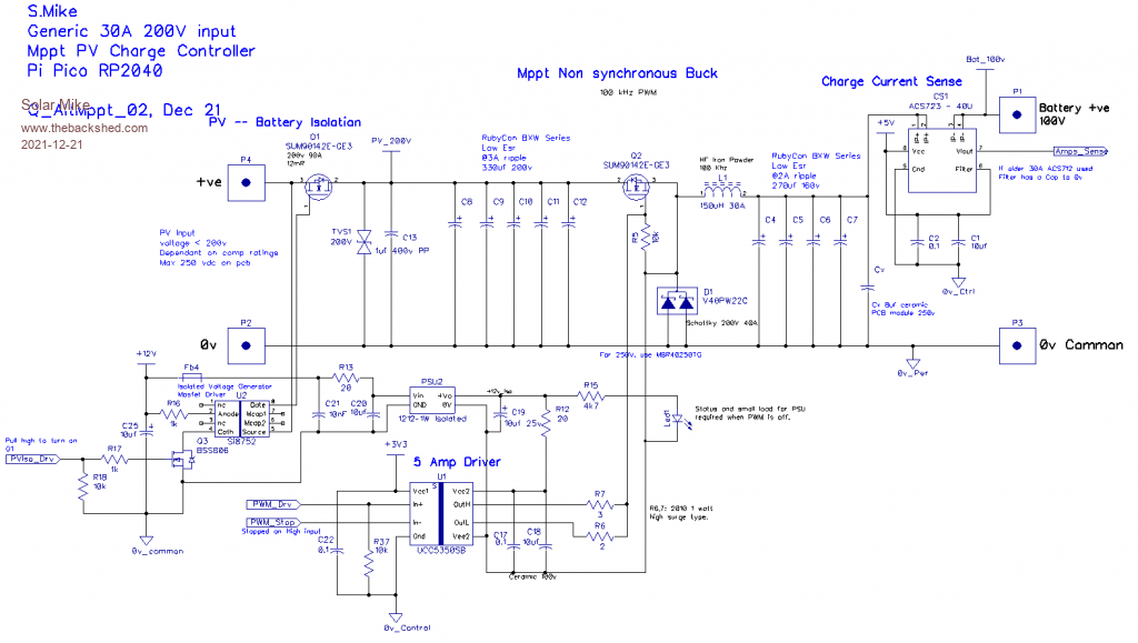

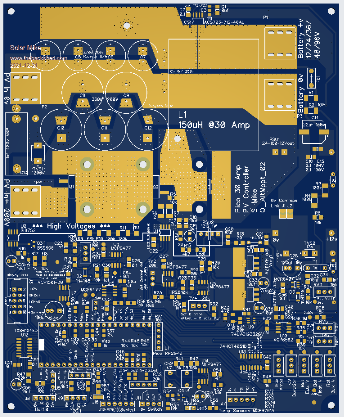

Last one for 2021 I promise, thought I would throw together a smaller non-synchronous version, where all parts including the buck inductor fit on the pcb. Less current 30 amps and using smd mosfets. The pcb conducts the heat through to an alloy spacer under the pcb to the heatsink - back panel.
Schematic and gerbers attached, anyone wanting to build go for it, sorry it will be next year until I have some software.
Top: 150 x 183mm
