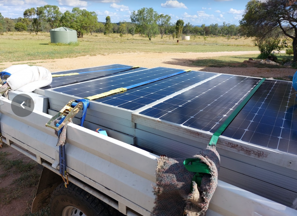

Some cabbage was too lazy to take these to the tip. Wouldn't even take money for them. What a steal.
I'm told the GTI works so I'll give the homemade inverter a go so I can backfeed and avoid buying a charger.

  ryanm said  Some cabbage was too lazy to take these to the tip. Wouldn't even take money for them. What a steal.
Yes .They can't be legally used on GRID systems any more . Its Off grid use only so if and when buying its good to know . Same with the inverter

Yeah, from the little I know about it in Australia the CEC or who ever makes the solar regs is pretty much government sponsored organised crime.

  ryanm said  Yeah, from the little I know about it in Australia the CEC or who ever makes the solar regs is pretty much government sponsored organized crime.
I gotta get a ute like that I can put panels 3 along in! Mine I can only get a single stack in but I do pile them 35 High!   :0)
