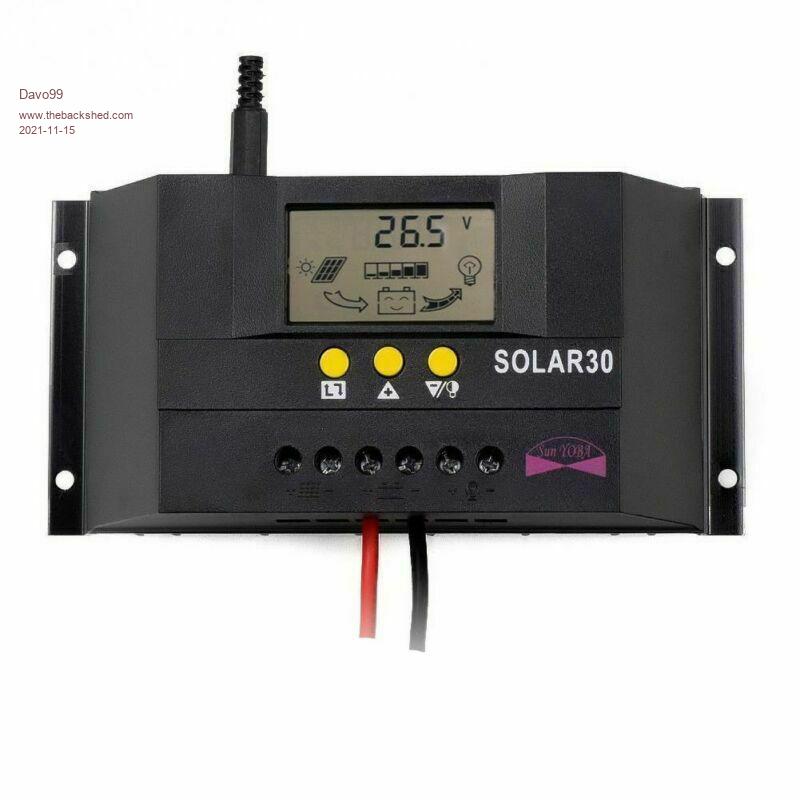

This is the controller I have and love.  Works perfect, easy and logical to use, been 120% Happy with it.
These appear to still be available from a Seller ( at inflated cost) but there is also a slightly differently presented version of the same thing with these units which have a model Number.
The problem I have found with these ATM is they all appear to be sold by one seller on Fleabay Oz at least whom has about 30 different seller names and equally bad reviews with endless complaints about Non delivery with all their store fronts. Fronts being an appropriate term. .

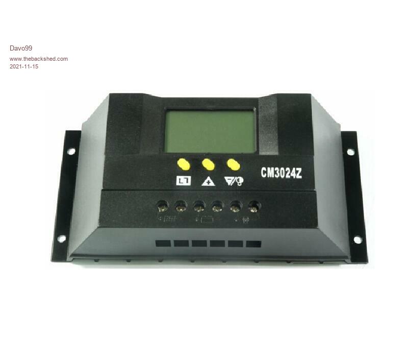

I found these which I had previously discounted as every controller I have had that was coloured blue which was complete and utter garbage of the "Kill your battery one way or the other " variety.
But I noticed some similarities between the good one I have and the crap ones.
Here is the "run for your life" type.

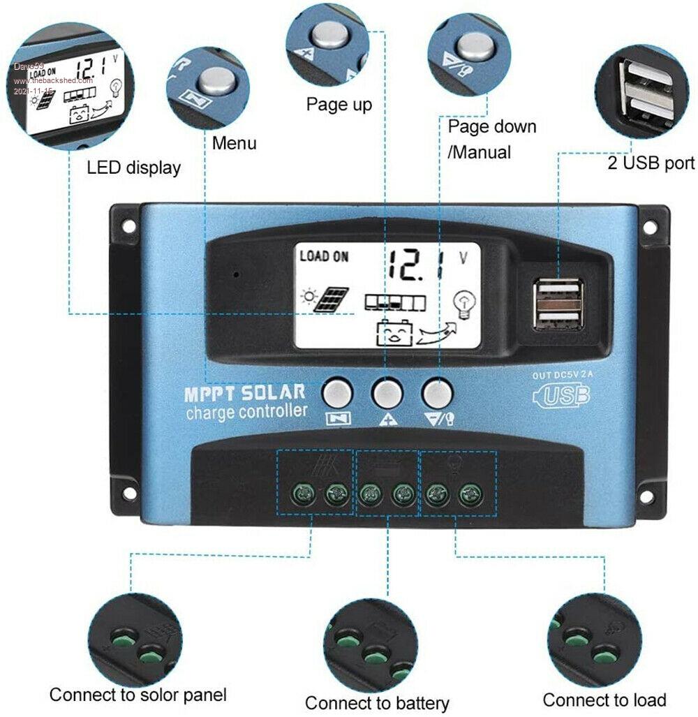

Here is a similar but what I believe good and decent type:

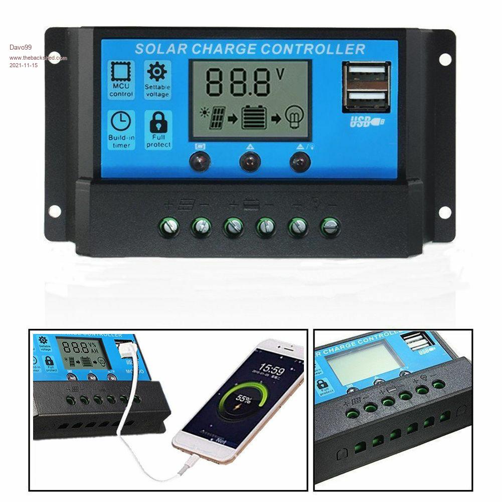

Now if you go back to the first pic of the good one I have and this one, You'll notice something... what I call the battery happy face on the LCD Display.

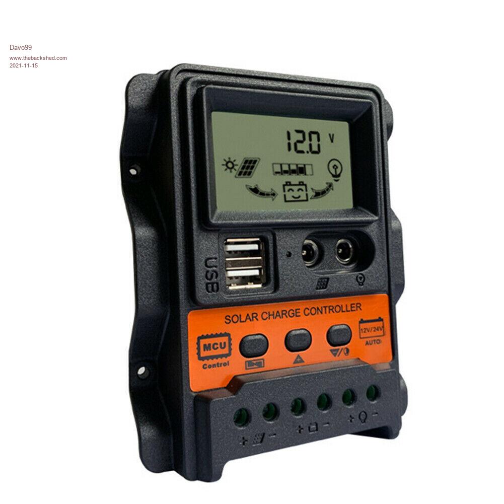

The other one with the battery that doesn't smile ( How Rudeness!) is the "Boil or starve your battery to death" type and the one with the smiling battery seems to indicate the look on your own dial when you have one of these worthwhile types.
Would be hard to come up with a graphic to illustrate the Look of frustration and annoyance I have had trying to do any settings with these other POS types that flat our more times than not just don't work properly at all.
In all of the smily face types I looked at, and there were other designs of casing, They all if one delves into the Chinglish destructions, reference to the voltages for float and cut-off being " User adjustable" which is exactly what is needed.

The advantage of the "Blue" appearance models seems to be they are being sold cheaper, sometimes substantially, than the black cased models.... for whatever reason but again I am pretty sure they are all the same controller being the happy or not so happy face Type just thrown into different casings. The other thing is I found sellers with much better feedback flogging the blue ones than some of the others but do your homework before you click the Buy button.
I haven't looked at whats on the other sites but from what I have seen before, they are all the majority of the same and generally Fleabay is cheaper and there are local sellers ( supposedly) where you can get the things faster so you don't have as long a wait to be disappointed and frustrated.
I am very SUSPECT on the happy face models being different amperage outputs as frequently listed.
