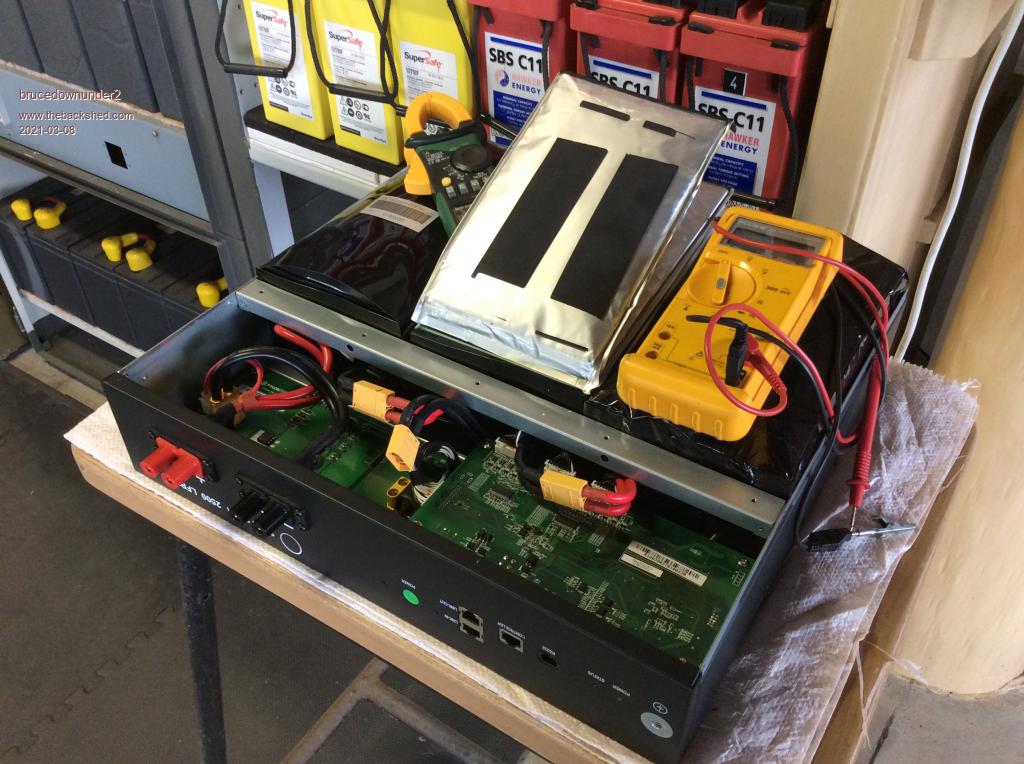

brucedownunder2
Joined: 14/09/2005
Posts: 1548
Posted: 01:25am 09 Mar 2021
Oh,,,,,
DANGER.   I GET IT
I'll remove the packets ,Carefully, and take them to a recycler depot .
I'm not interested in even trying to figure out IF. after reading the couple of previous warning posts, thank You.
I'll keep the bus(battery management system) and battery charging module ...Some one further down the track may have a use for it or know of a way to use it again.
Thank You ,
Bruce.

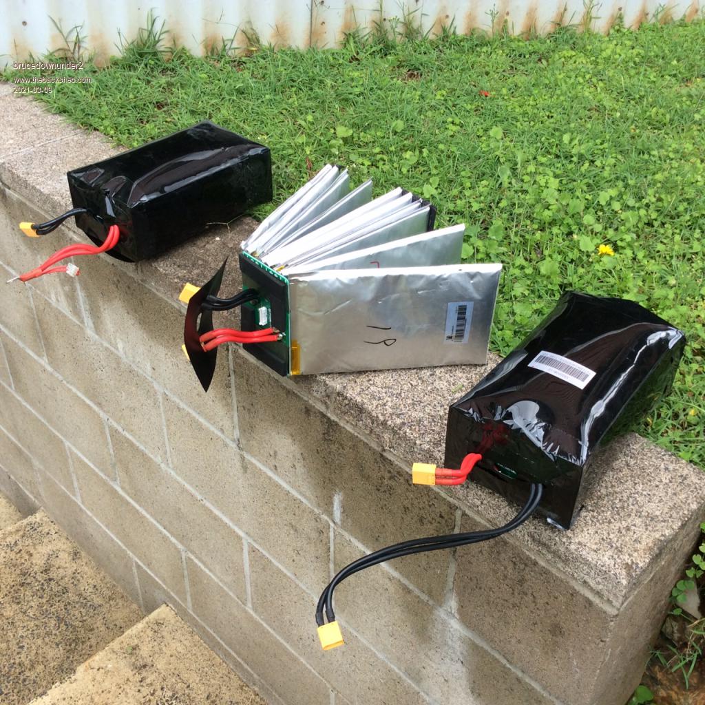

brucedownunder2
Joined: 14/09/2005
Posts: 1548
Posted: 02:11am 09 Mar 2021
I just remember you posted about a car jumper starter pack . I have one of those ,must drag it out and take it to the recycler also ,,,,, could very well be dangerous,thank you.....
There is no warm feeling on these packets . So at least that's a good sign.
Looks like the connections from inside the packets ,from the plates, to the pcb outside ,is  connected by some form of heat compression or maybe crimping ?. I,ll keep the flyleads and connections ,they look good for other projects.
I,ll now warn my friends if they come across these type of batteries, thank you for your warning..
Bruce

brucedownunder2
Joined: 14/09/2005
Posts: 1548
Posted: 11:30pm 04 Apr 2021
OK,
  back to the batteries--  My friend ,Aaron is progressing along the path to bring these "modules-Packets,pouches" back to life.
So far ,after a few light voltage charges, medium current, he's managed to "wake" a pouch up from flat.
I won't jump the gun yet, a long way to go ,but fairly good results so far .
He or I will keep you informed,
Bruce

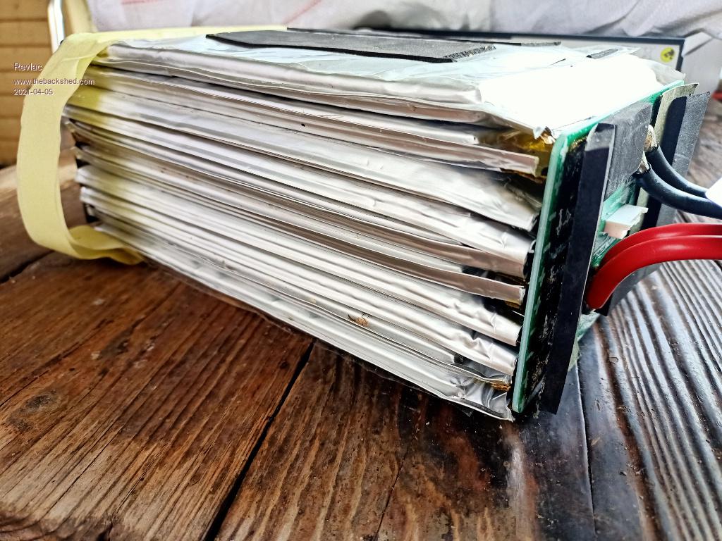

Before attempting to charge this pack I wrapped up the back end with some masking tape to help hold it together.
I tried charging the one that has the black plastic wrap removed, I set the charger to 6v then connected it up turned the charger on and it maxed out at 40Amp for 3 seconds the dropped back. I then gradually increased the voltage as the amps dropped, after about 10 minuets I reached 12v on that pack.
Turned it off and disconnected over night, checked the voltage the next morning and the battery was dead flat, Did the same cycle again the next day  and the battery started to hold a little charge of about 1.5v.
Did the same cycle again, this time it was holding over 6v, looks encouraging.
Will do this with the other packs.
These are Lifepo4 pouch cells, LFP.

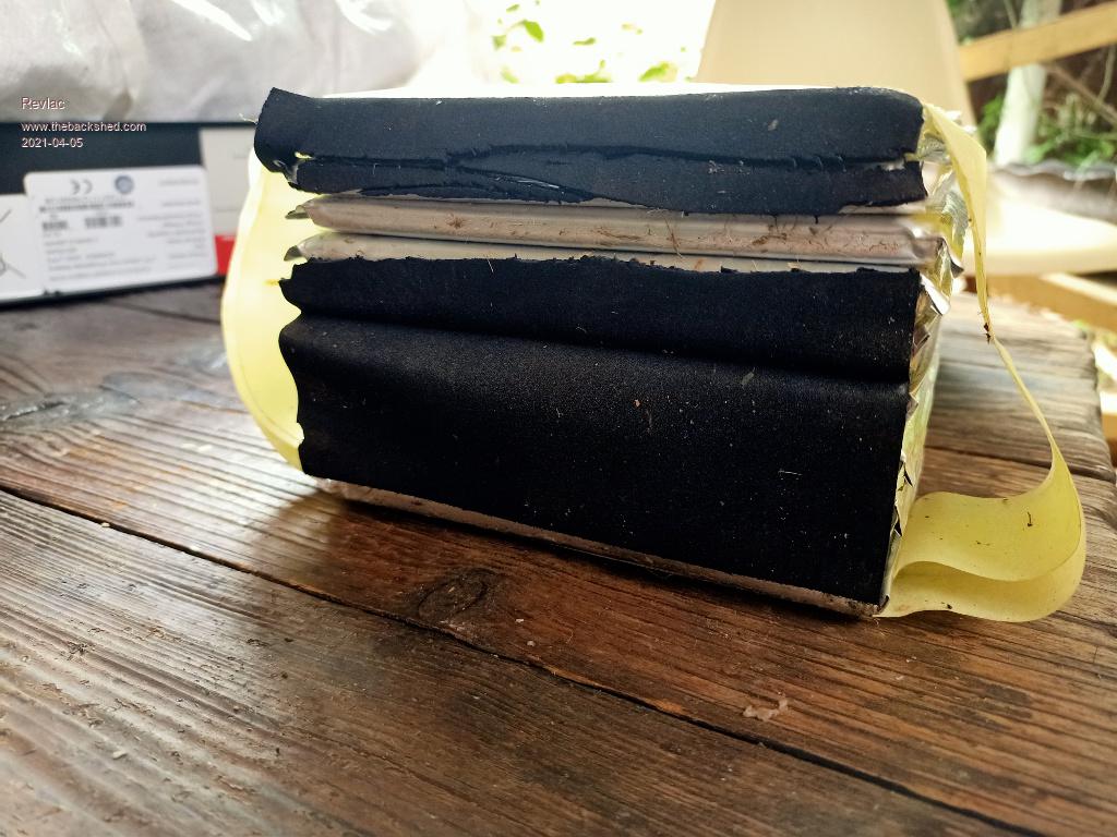

What We think has happened with this Flatpack is that it was left sitting flat (Discharged) for a long time.
An overcharged cell that has swollen up would not flatten out with any recharge.
Now in the photo you can see the masking tape is really slack, what is most surprising is the cells (while charging and left for some time) have sucked back down flat most of the way, was expecting that.
While charging this pack I did check every cell often to make sure none of then where going over voltage, it was nice to see all cells in this group where charging and voltage was equal on each cell.
Will have to peel open the cover on the end of the other 2 packs to check the while charging, see if they do the same thing, there is a small chance that they might might all charge up and work, will take some time to go through this process, but definitely worth trying.
Thanks Bruce for letting Me work on this.
Can't say for certain that all this will work, too early to tell, there is also the issue of high resistance that could make the battery difficult to use, will wait and see what happens...
Cheers Aaron

Hi Crew.
Well,Aaron has been busy getting these batteries back to some sort of decent charged state.
He,s done careful voltage charging ,setting the voltage to recommended voltage,and constantly observed the rise. He,s observed  only slight discharge,but more importantly, a big decrease in the physical swelling has occurred,which indicates a positive reaction to the charging cycle .
So, success may be achieved after a few more cycles,well done Aaron,and thank you.
I have been thinking ,that this flatpak unit may have just been neglected from new and or maybe charged incorrectly ,in the first place ?. As it was looking brand new and unused when I obtained it.
Bruce

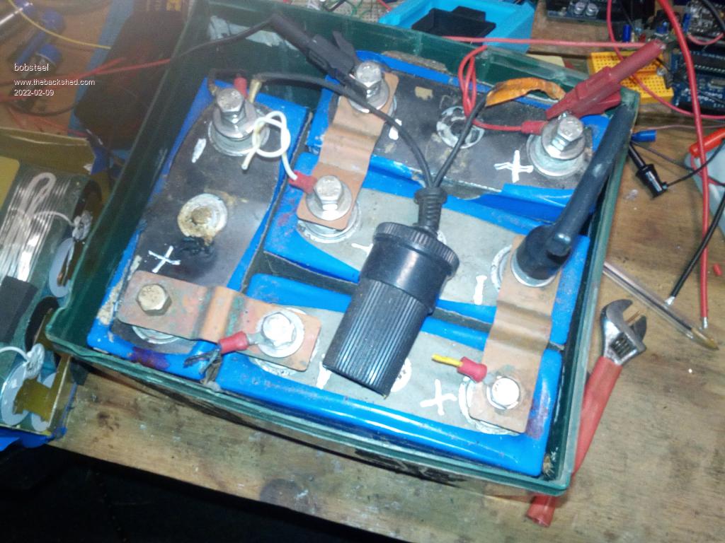

The below applies to LiFePo4 cells (3.65v) and probably LI (4.2v) too.
What I have found works is a pulse of high voltage for only a half second to burn the dendrites out. It can stuff the cell anyway but I have successfully recovered two cells that were fully flat or nearly so ,0.06 volts
I set my lab supply at 40 volts and just touch the terminals about 4 times for half a sec at a time.
The interesting part is that lithium based dendrites form and its been found to be the ethylene carbonate electrolyte responsible , This seems to mostly be caused by the recharge going up near 3.65 volts . If you keep the max to 3.4 volts they are still fully charged and supposedly no dendrites form.
Its also known that over charging creates copper dendrites that can be treated the same way.
If you store them try to hold them at about 40 % capacity it is said but the difficulty is finding what voltage represents 40 % charge so I think that's a furphy or rabbit hole.
If they have swollen it means usually too much charge or discharge has been applied and its common for people to believe LFP means big charge capability .
The cells I have seen inside of can only take .5C charge and discharge or they suffer damage . The rest is sellers hype.
If swollen the electrolyte has been gassed by the heat created on charging/discharging and the only thing to do is stand the cells up so the liquid electrolyte flows back in then slightly compress the cell ,drill a small hole in the top ,squeeze some more and then immediately plug the hole with glue or silicon rubber or something . Do not leave exposed to the open air as the alloy tabs connecting plates to terminal will corrode very fast.
Those cells I did as above are still in use 4 years later and surprisingly the capacity is coming back up!

The cells are sort of on the back burner for a bit While I work on other things.
My intention was to try a pulse charge on these cells, as they will take charge but not hold it.
The way I was thinking was to use a capacitor bank of reasonable size (what I could find), the power supply would be coupled to the capacitors with a current limiting resistor to save thrashing the power supply, the capacitors would be charged, then using a switch or something appropriate to dump it into the cell's.
I have seen plenty of different cells swollen over time, overcharge or discharge, and Generally if they are still working I have let the pressure out of them sealed them and kept them in use, over a year so far.
Charging one of these cells will keep gassing off over time.
Also seen some cells swell over just sitting unused over a few years.
The cells in the photo's above were swollen and would have expected them to keep swelling when attempting to charge them, but no, not this case, Attempting to charge these did take all the current the charger could put out, for a short time until the cells voltage had risen some amount.
The pressure in these cells diminished after charging several times, not up to full voltage, when left they lost some of there voltage over night and continue until almost flat.
I have left them sit for some time and now they are tight as if they are vacuum packed.
Will get back on to this soon and try pulse charge, see what happens.
Cheers Aaron
