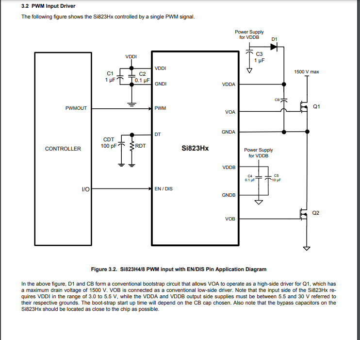

Whilst doing some research, came across some of the new design D2PAK-7 mosfets, they are very impressive, along with a better driver chip; so thought I might throw something together to give them a try out. I quite like the idea of not using a separate driver pcb module and using a bootstrap technique for the upper mosfet drive supply. The D2PAK mosfets allow a better layout over external TO247 types.
This latest design version 4.x uses a Silicon Labs Si823H4BB-IS1 isolated half bridge mosfet driver chip driving D2PAK - NTBGS4D1N15MC mosfets in a synchronous buck format; these ones are only 150v rated so PV voltage limited here.

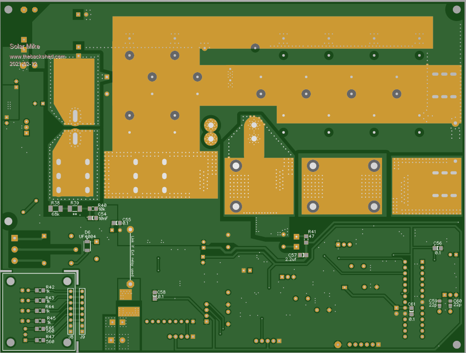

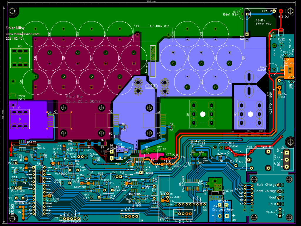

First cut of PCB 155 x 205mm:
As yet no schematic and no vias added on the pcb yet, just built on the fly, will do a schematic to pick up my errors.

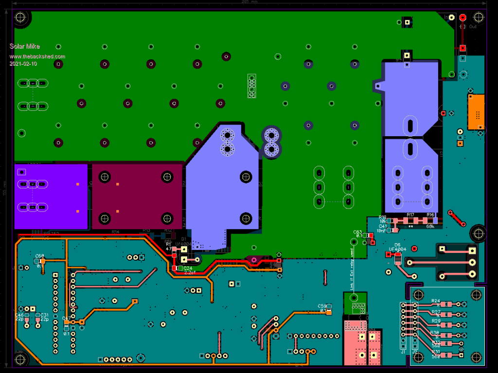

Here's the final as yet unchecked layout, added those vias, just over 1100 of them, could never had prototyped a DIY version without the low cost of getting boards made in China. Big yellow tinned areas need additional thick copper wire soldered to pcb to support 60A current - with prototype's 1oz copper.
I have placed all high current carrying circuitry in the upper half of pcb, low power control, cpu etc has its own separated ground plane, with a single 0v connection point at the main PSU. Will see if I can locate any higher voltage mosfets for this so I can test it on a 100v battery bank (190v PV)

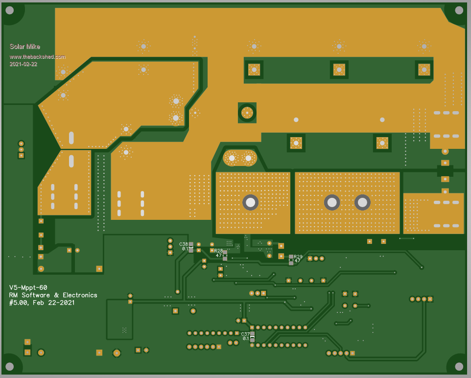

Top:
Bottom:
Will do a schematic next to check layout.

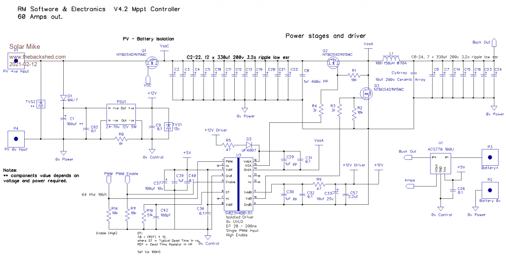

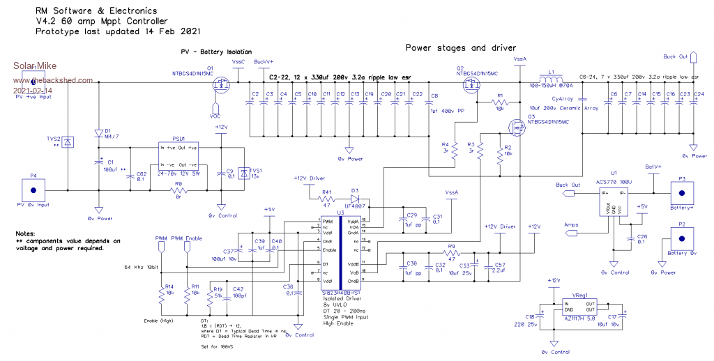

Schema for power stages.

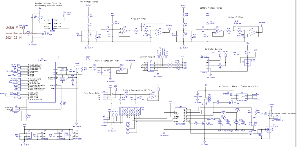

Posted: 09:41am 14 Feb 2021
Updated complete Schema, pcb layout checked, couple minor reposition changes, so wont repeat it. Send off to be made, Chinese new year, may take a while.

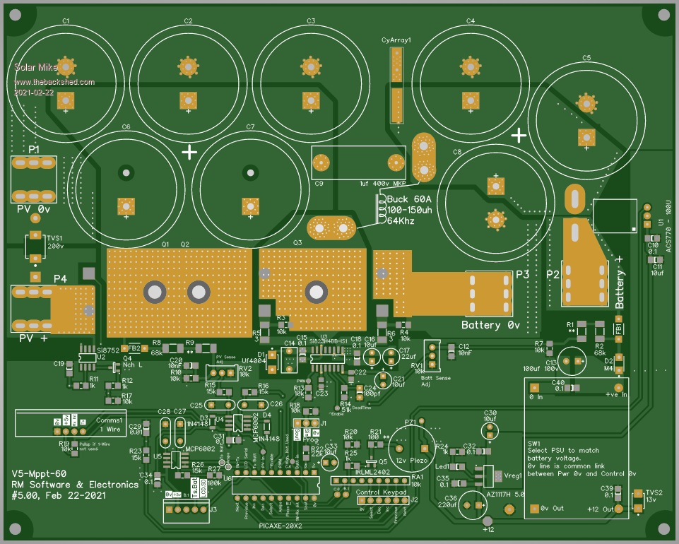

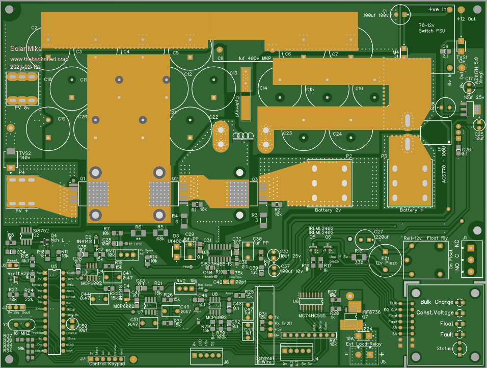

Update: Finally sent the gerbers off today, delayed a little due to creating another design. I was intrigued by the possibility of mounting the larger TO-247 mosfets in a similar manner, surface mounted with the pcb vias acting as the heat conducting medium to the heatsink under the pcb; in this case the mosfet mounting bolt clamps the device to the top surface when screwed into the heatsink below.
Have no idea how well this will work, but means I can use the higher voltage devices for PV exceeding 200v.
Edit: caps I'm using here each have a ripple rating > 5amps, those cheap hunglow brands just wont work here.
So sort of threw this one together, its got just the basics to work, no Blinky lights, just an lcd serial display and piezo, have opted for the 30-35mm caps here as I have a box of them that need using up.
Pcb is 160 x 200mm.
I wont be creating a schematic of this, its basically same as above without the extras.
