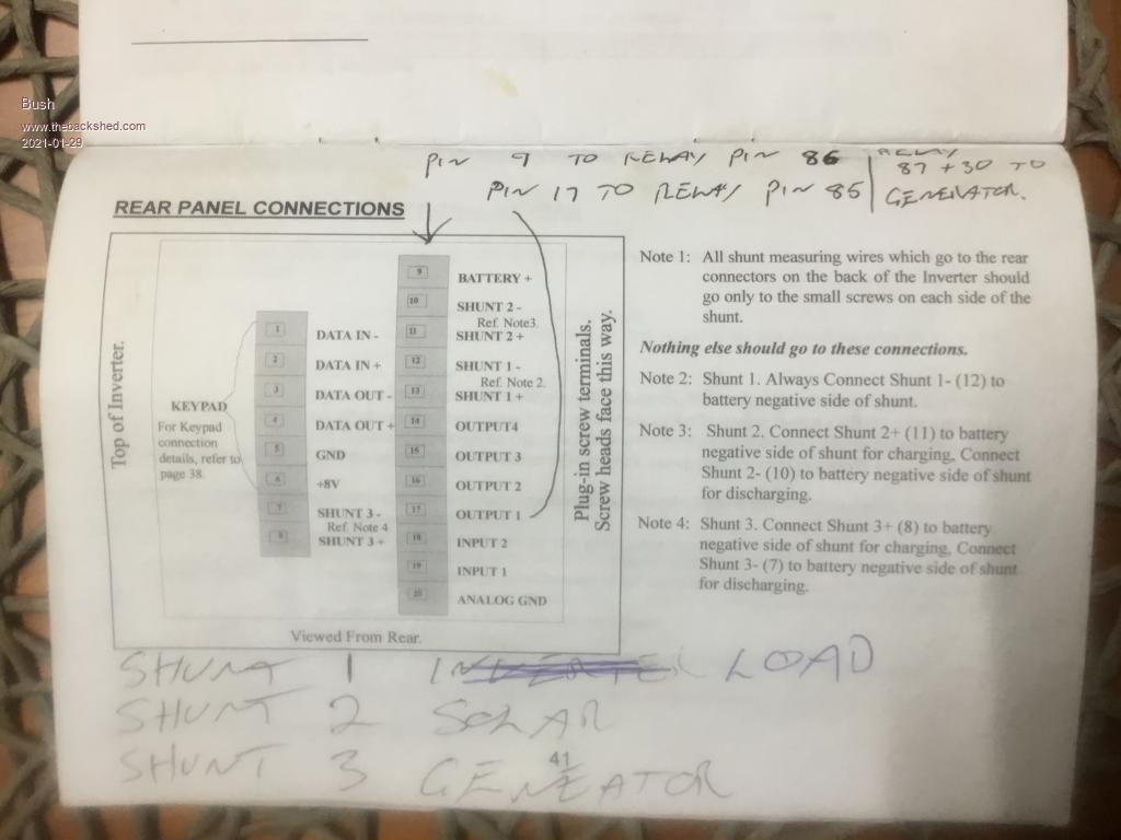

Pic is what I did at the time of wiring up the generator.
Not sure if that helps shed any light on it?
pd--
Joined: 11/12/2020
Posts: 122
Posted: 07:22am 05 Feb 2021
You can connect up your manual switch to pin 87 and 30 on the generator relay
that's mentioned in the selectronic manual
This will only allow you to manually start the generator and stop it if it was manually started.
for an indicator light you could run one from the generator.
an output from the generator that is live when the generator is running would be best
or you could use the wire that operates the fuel solenoid.
Turn off the power & disconnect the battery before changing anything
one little tap of the wrong wires together will blow up the electronics
