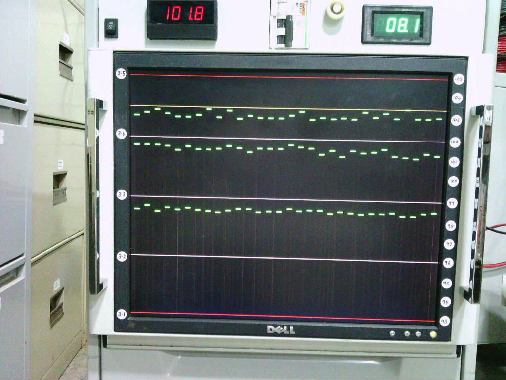

Here is my early BMS design (2019) showing thirty cell voltages, plus the max and min peak voltages reached for each cell. The circuit breaker has a shunt trip coil to disconnect the battery if any cell goes beyond limits.You can see charging terminated when one cell hit 3.45v exactly.
It would be difficult to engineer in more monitoring or more protection, but three cells still spontaneously died in the exact same way over three years.

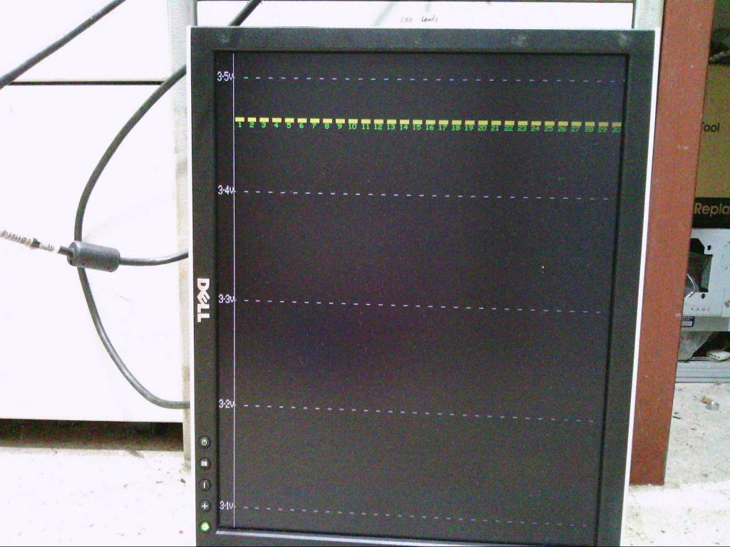

This is my latest version with a much higher resolution home brew video board, just the bare VGA board under test, not hooked up to a battery here. The voltage bars change colour when the discharge load is active on a particular cell. Pretty happy with how its turned out. The crappy photograph below looks grey and grainy, in real life its really crisp and sharp.
I am just slightly fanatical about looking after the battery as you can see, its quite an investment.
But all these cell failures are still rather worrying.
I still need to order three new cells from Trev, running without the battery right now.
