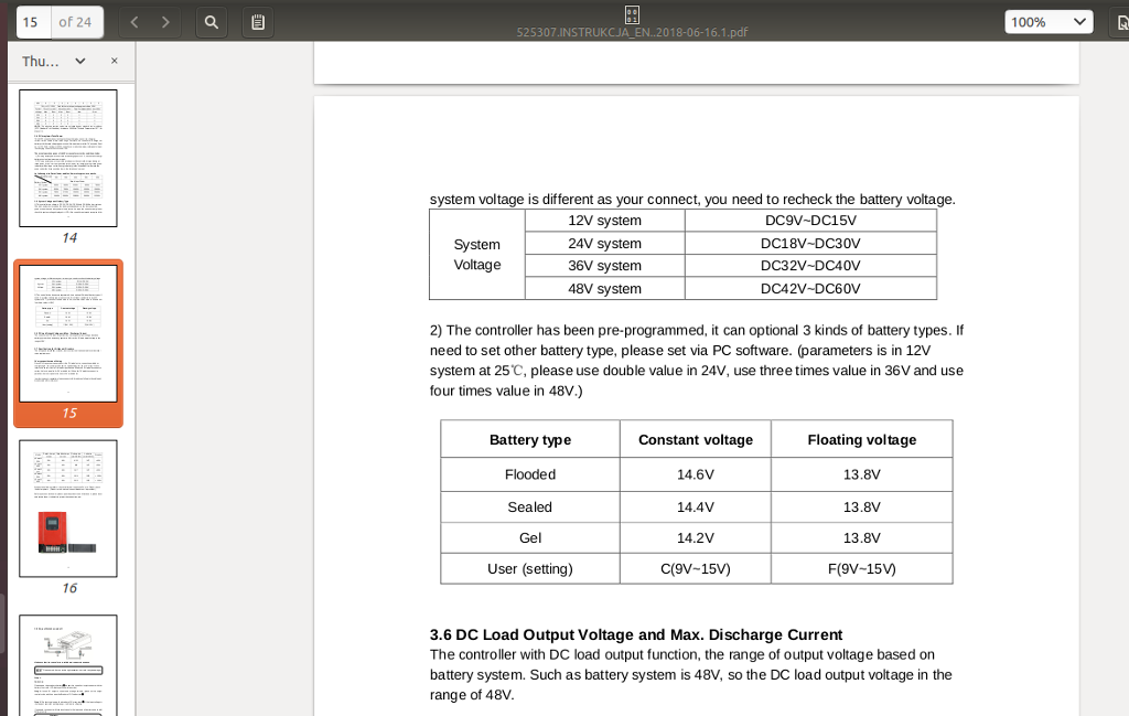

I think it is an eSmart3 MPPT 60a.
And this might be the Manual for it.
Looks like https didn't work.
I will read the manual, see whats not.
Edited 2020-09-24 17:45 by Revlac
Cheers Aaron

It could be on the constant voltage stage  CV. 14.6 X 4 is 58.4v
You could try "user setting" and set it to what you want.
Take a photo of it working, perhaps we can see what is happening.

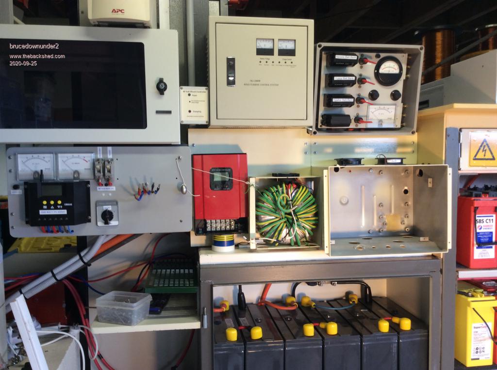

This is a pic of the red/black MPPT controller .  Aaron has suggested that a previous owner may have had it set for a higher voltage (his type of batteries) . -but I'm sort of thinking I've bought someone else's problem ??.
I'm waiting for full sun and I will try to re-configure the menu for my lower voltage batteries. I'v read the instructions ,but @ 76 I'm not smart in that dept. anymore.lol.

Ok then,
If the voltage in and out is the same, and the controller Doesn't indicate any charging, it seems like its just going strait through.
So perhaps a shorted fet, or not switching and not doing its MPPT thing.
Gizmo posted this link http://skagmo.com/page.php?p=documents%2F04_esmart3_review earlier and there is a schematic as well.

There is good news, .   I spent many nights thinking what the hell could be upsetting this controller.
So, I came into the workshop and pulled Everything connected to it off..
BINGO,   An hour later, it,s working !!!!
What did I do ,differently, smart arse me thought I could cut the bulk of cables leading from the components to the individual destinations ,,,,,,and take ALL the negative conductors to a buss bar ,then only one Neg conductor into the back of the enclosure..
Of course, I forgot that this does not apply to components that require their own individual connections..
Thank you, and I,m sorry to have put you through something that was my mistake.
