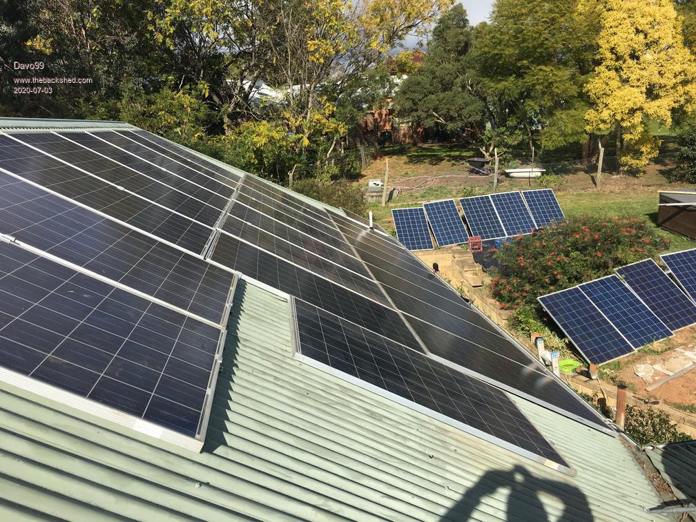

This was the array I put up last week and got my roof legs and tactics worked out.
24 x 250W panels.  Still enough room from the end the picture was taken to add another 12 panels so I might extend the strings from 8 to 12 to end up with one less.
That will be 3 Kw on a 2 Kw tracker so should be OK given I'm really chasing winter yield. Ground test array in background (That's been there a year!) will be finally going up on the roof to make way for outdoor bathroom and landscaped spa area to go in when Tractor finally arrives from stealership.

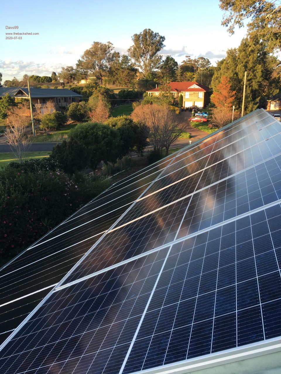

The finished array. These new panels look pretty good I reckon. About 95% of that roof area is covered bar a couple of angles at the back end. I put extra clamps on the end panels as we get scary strong winds here and the end panels are the ones that cop it the most. There is a small overlap on the top ridge of the roof of about 100MM which isn't Kosher these days although the neighbours panels have a lot more overhang and they were installed by someone " Licenced". Quite a few things with that setup I wouldn't do myself and think are dodgy but anyway.
The great thing about not being solar certified is everything you do is automatically against regs so no need to worry about complying from then on! :0)
No roof Isolators on this setup and I'd never entertain the idea of having them anyway. 100 times more problem than they are worth. Another benefit of not having to comply with often stupid regs.
I'm more than  satisfied no panels are going anywhere less the Colourbond and the roof trusses go with them.  Also satisfied that the roof is now less likely  to ever leak than it was before.
