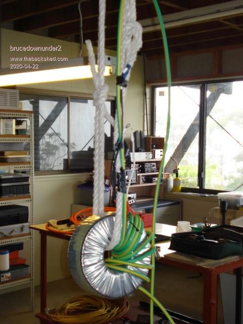

Some time back ,like years,lol, I meant to show how to torture an old mans fingers.  This outer primary winding was /is 20mm covered earth wire, not very flexible, had to use a soft head mallet to form the bends ,sometimes.. I think it weighed something like 20 kilos with all the wire wound on.
So, you can see why I had to find a seperate case for it ,Just would be too big for the inspire inverter case.
Also, so heavy ,I had to rope it up to work on it ,could just lift it, but I am 76 years stupid.
Never again,lol.

That coil(transformer) I rewound for a less stand-by demanding power in a Powerstar W7 6Kw x48Volt inverter.
