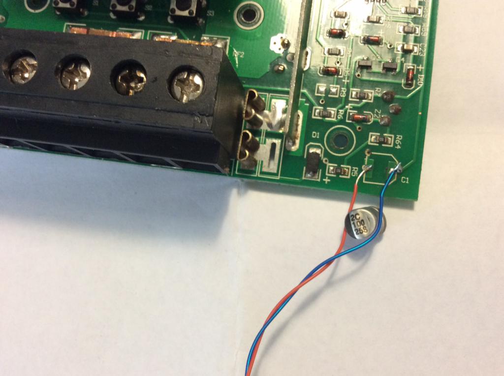

I must have done something about face or connected incorrectly -maybe?? don't really know ,it just stopped showing the solar charge symbol ,the little flashing arrow that shows a solar charge is going into the batteries.
Anyhow . I found a very small broken track on the board ,and bridged that out .
powered it up and smoke came out of a metal can capacitor (small fella close to the input terminals. Blew the can off the cap with a "BANG" and smoke and plastic foil everywhere.
so, I've fairly sure it's 100 v volts ,small value , sort of 4mmx 5mm tall cylinder type .
The question,
Has anyone ever seen a circuit for these Chinese controllers(possibly no ?)  or any clues ,like do you think I've much to lose if I power it up now -fixed track and new cap- She's only $30 ,so not going to break the bank (kids inheritance)

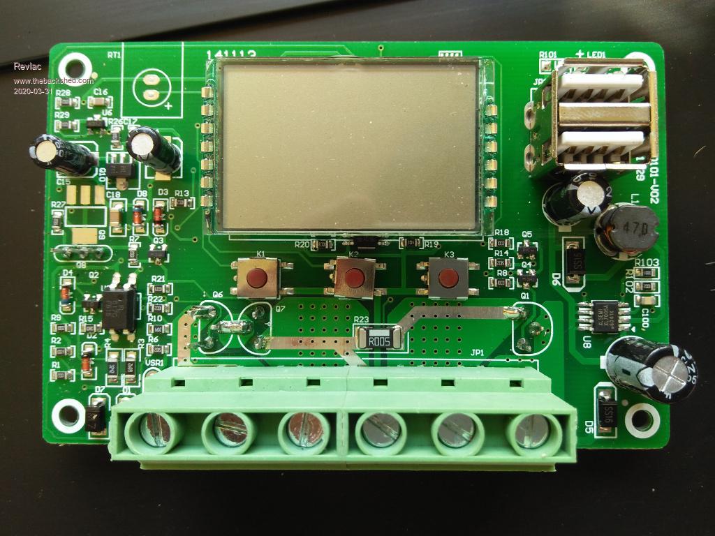

This is a different brand of controller but otherwise very similar in appearance (on the outside) the cap on this one is 63v 100uf.

I will post this here Bruce, if thats OK.
The capacitor markings, trying to figure them out, most I have seen had the values written on them, just not this one.
2C 100 258
Possibly 2c date code,  100 capacitance and the last set is the voltage code, OR it could be the other way round.... depending on which manufacturer or code is chosen.
Ideas anyone?
Cheers Aaron

100uf, 25 volts.

Posted: 09:26pm 31 Mar 2020
Thanks Mike.
I though it to be a higher voltage ,as the unit is 48 volts,but maybe the board voltage is reduced before that cap .
Has anyone seen anywhere that a replacement board for any of these controllers can be obtained..
48 volt models of this cheap cost are rare, most are 12-24,auto sensing of the voltage.
Having fun ,happy to just play with this . I,m back practising soldering in small parts under a magnifying light ,and scratching through my junk containers for parts. Rural means we just can,t run down to the parts shop .
