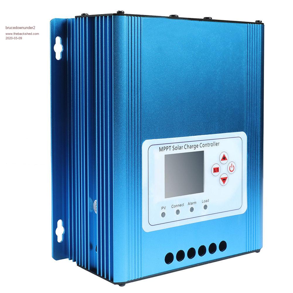

brucedownunder2
Joined: 14/09/2005
Posts: 1548
Posted: 02:07am 09 Mar 2020
This is the "Blue" one .
Bruce

Ok, Thought it best to add a little bit here.
My old MPPT Charge controller (3 of them) is a  PCM60X getting too expensive now.
Now I have been looking at these 2 Charge controllers with interest.
The Blue one as above,Blue one
CPE series controller. not sue if a Wifi dongle is available for it.
Seems to be strong looking unit.
And the red one
eSmart3 series is third generation of eSmart mppt controller,
Reading about the red MPPT CC it has a few things I was interested in, mostly the ability to setup customised battery setting's (all MPPT's should have this) it was not available when I wanted it years ago.
And they  the ability to connect to a computer via a Cable RS485, usb and Wifi dongle, SOLD SEPARATELY, unfortunately........would have been nice to have that in the box.
What is this RS485 anyway? Cable and protocol?
My old PCM60X has RS232.
Now has anyone had any experience with the blue one or the red one? I believe its called esmart.
They are both very similar units.
My apologies if I'v Stuffed something up, just difficult comparing these.
Gee that address was long.
Cheers Aaron

Posted: 09:38pm 09 Apr 2020
I bought a 100v 30 amp Make Sky Blue controller as a backup to my own controller after seeing Marks dead unit.
Mark was dead unlucky, his crapped out after only two days. There is a very small transformer and a switching power supply that generates multiple isolated dc supply voltages. One of the 12v supplies that supplies isolated gate drive power had failed.
The transformer was dipped in transformer varnish and baked into a solid lump. Impossible to dismantle or repair its so tiny. So the whole thing was unrepairable.
That transformer and the microcontroller are the only two very special parts that cannot be obtained or replaced with a substitute part.  Just about anything else could be repaired somehow, unless the whole thing turns into a total charred mess.
Anyhow, I bought one and it works fine, and is still working very well. The whole thing is built inside a very light gauge aluminum box, and even at low power the internal cooling fan was always going full blast. That is its only real limitation, at full grunt its going to get really hot and probably fail fairly soon because there is nowhere for the heat to go.
So what I did was bolt the whole aluminium box onto a massive "Inspire" heatsink and hang it on the wall. The heatsink sucks the heat right out and now the fan never comes on, and it runs cool to the touch even when running flat out.
After a bit of help in the heatsink department, these work very well, and I would certainly buy another if I ever get around to installing more panels..
