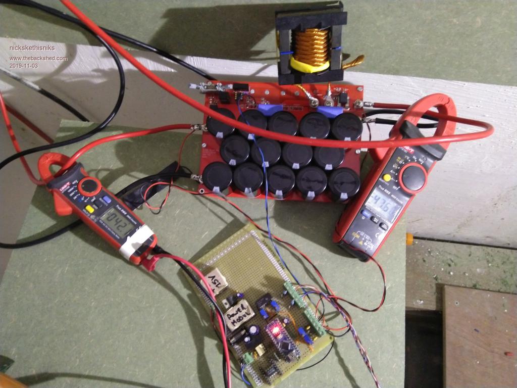

So this year I made a few experimental buck converters, and guess what the most simple concepts worked best . Once I made a verry simple design with just one irfp4110 a diode and 2 caps with long wires to an arduino nano with a tlp250, it worked for months, I put it out of service now.
I did experiments with snubbers, cycle by cycle current measuring with current transformer (difficult with high duty cycles). All kinds of inductors, capacitors,... I learned a lot, didn't blow up things tho....
I made a pcb in july this year, finaly got it tested today!
Software is written verry poorly in arduino, but it works, it's just a litle bit slow when I disconnect the battery, so the output voltage rises to much, thats just software.
So I used 2 parallel mosfets (irfp4110), 2 dual body diodes 30cpq100 in parallel. For gatedrive I used 12ohm resistors on each gate to a tlp250. Switching is done on 31khz. The inductor is an etd59 with about 100uH, it has 1mm airgap.
I tested to about 62Amps going to the battery, @ about 40Amps there was 15% more current going in to the battery! With 30 amps there was no cooling needed, with 60 amps going in to the battery, a fan was required to cool the inductor. I only made it for 30Amps (4amps/mm²).
I used 9 elco's epcos 1000uF 300V on the input and 5 the same type on the output, I have hundreds of those laying around, NOS from ebay.... Also 4.7uF MKT on the input and output. ACS758-100 was used to measure in and output current.
The concept could be verry easy adjusted to other input/output parameters.

Posted: 03:05am 03 Nov 2019
That is a truly great effort there Nick.
Its now just a case of tuning up the software
Belgium is going to be just a little bit different to Australia!
Probably the biggest issue will be how many cloudy days in a row you are likely going to strike in winter. There is no substitute for local climate experience.
That is going to be the killer, and when the sun stays away for several days in a row, more panels or a larger battery are just not going to help. I believe a battery charging generator of some type is going to be a necessity at some times, even if its not very often.
Until you have experienced at least one winter, its not going to be really possible to estimate your typical consumption or solar input with shorter days and longer nights.

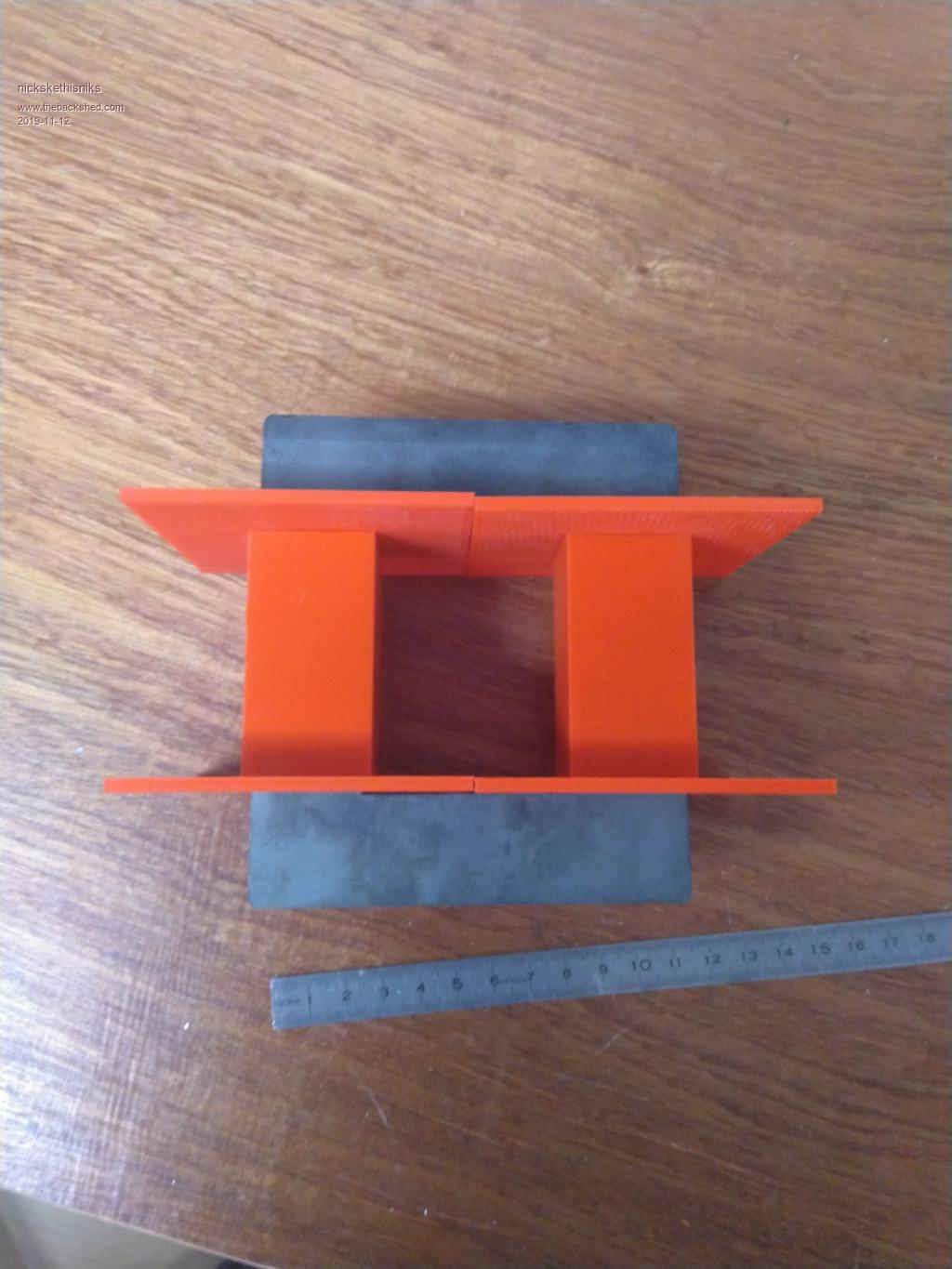

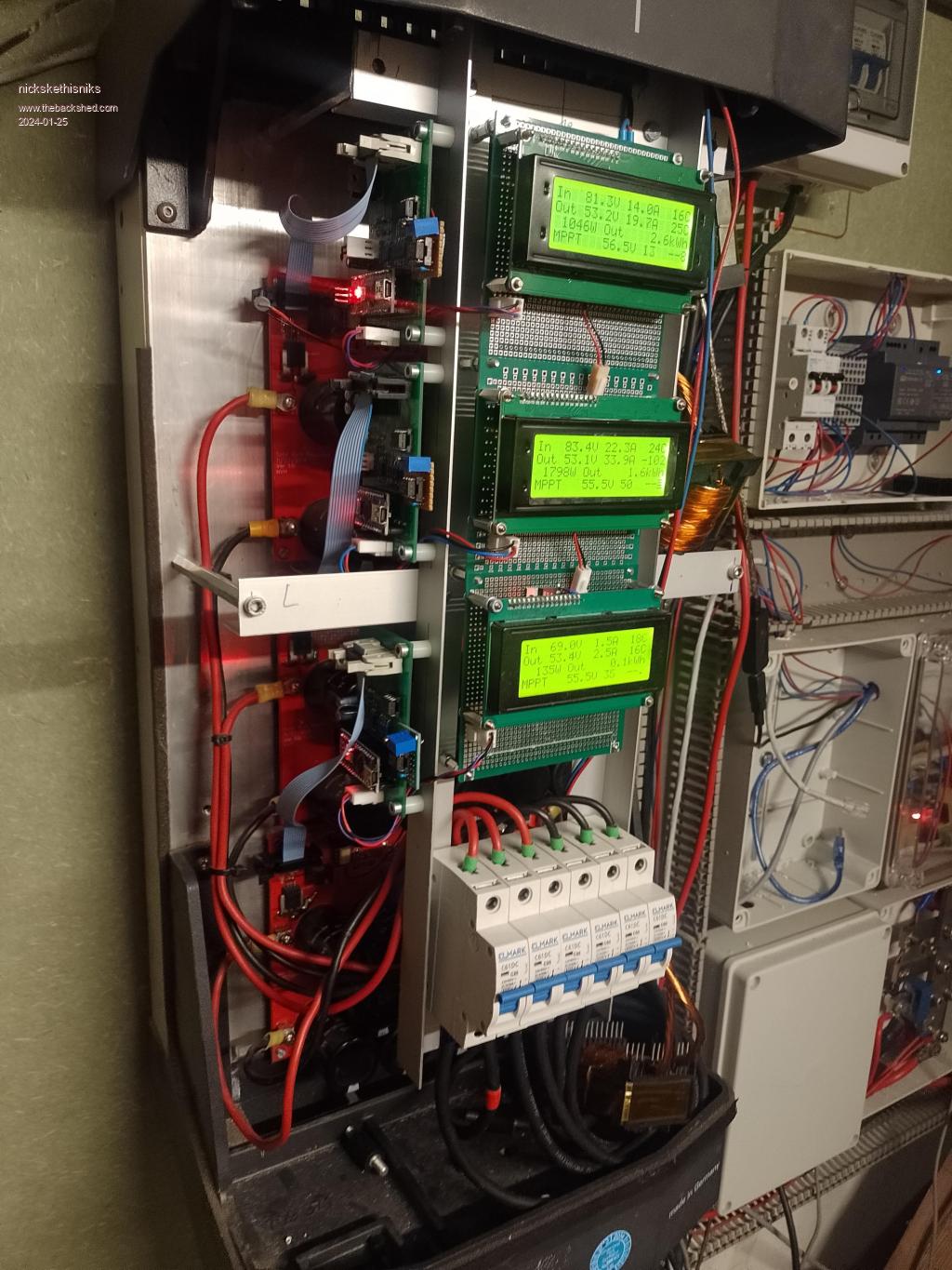

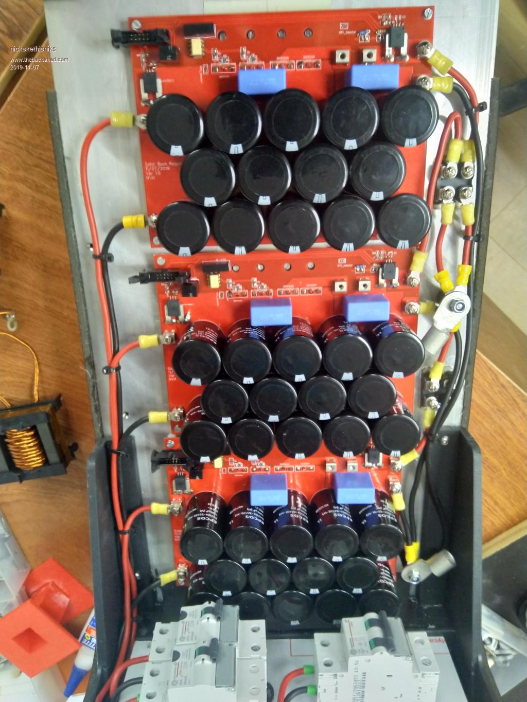

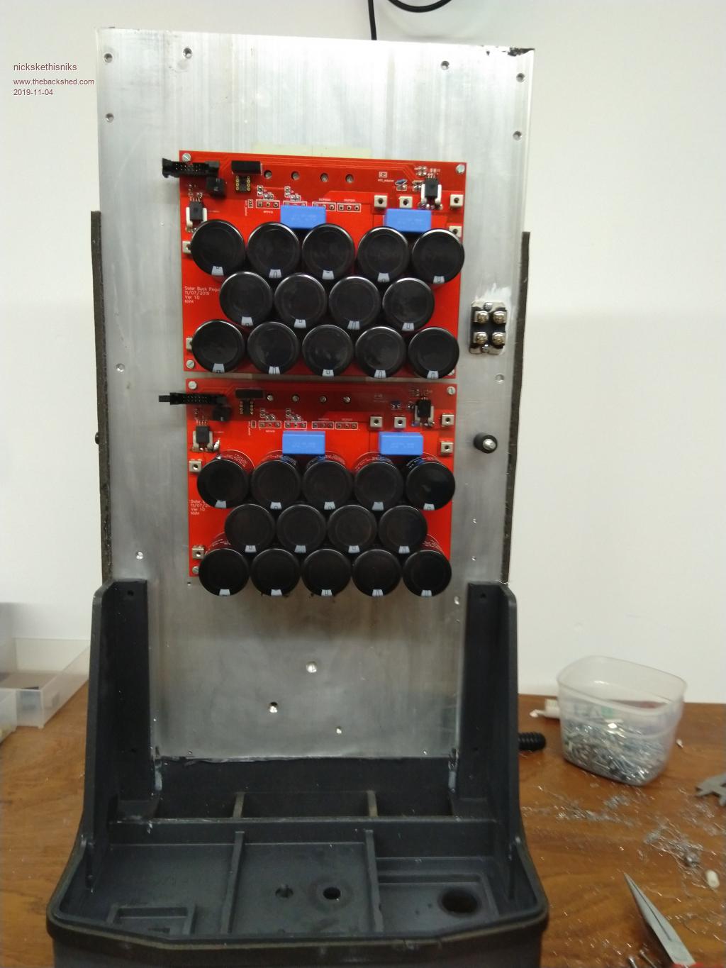

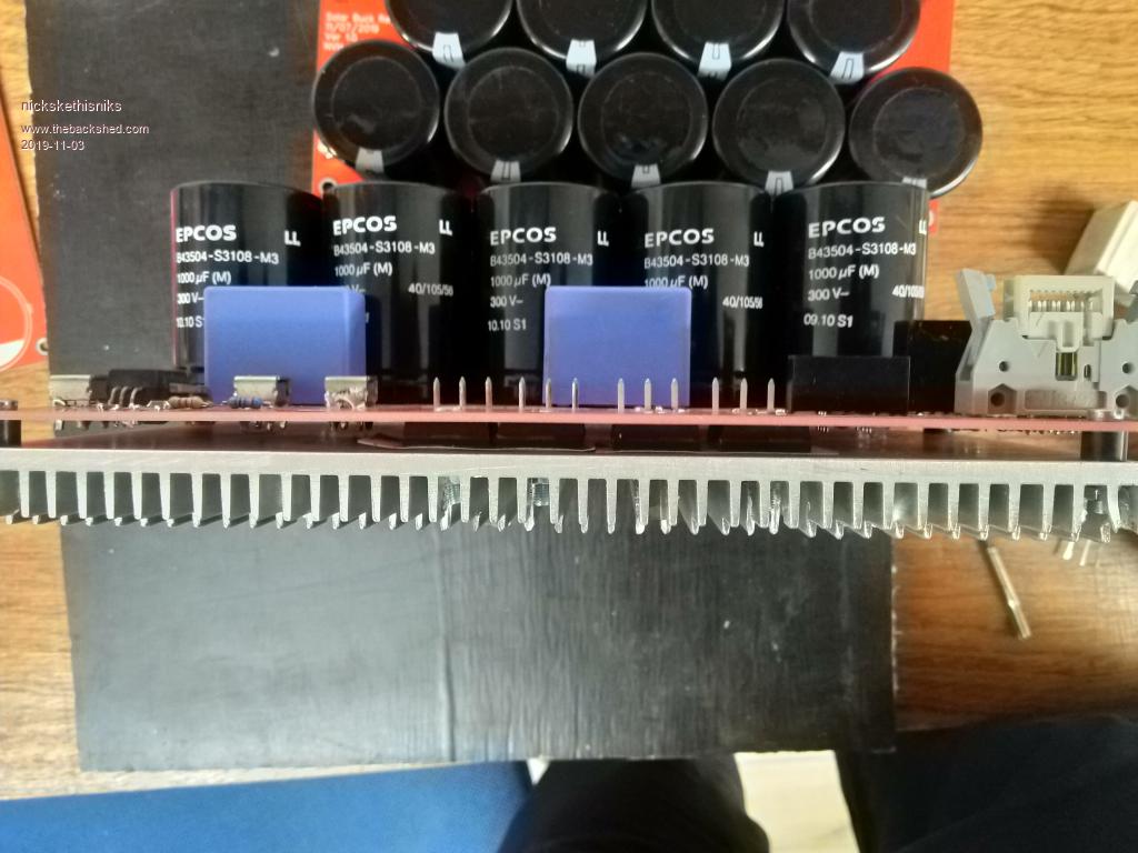

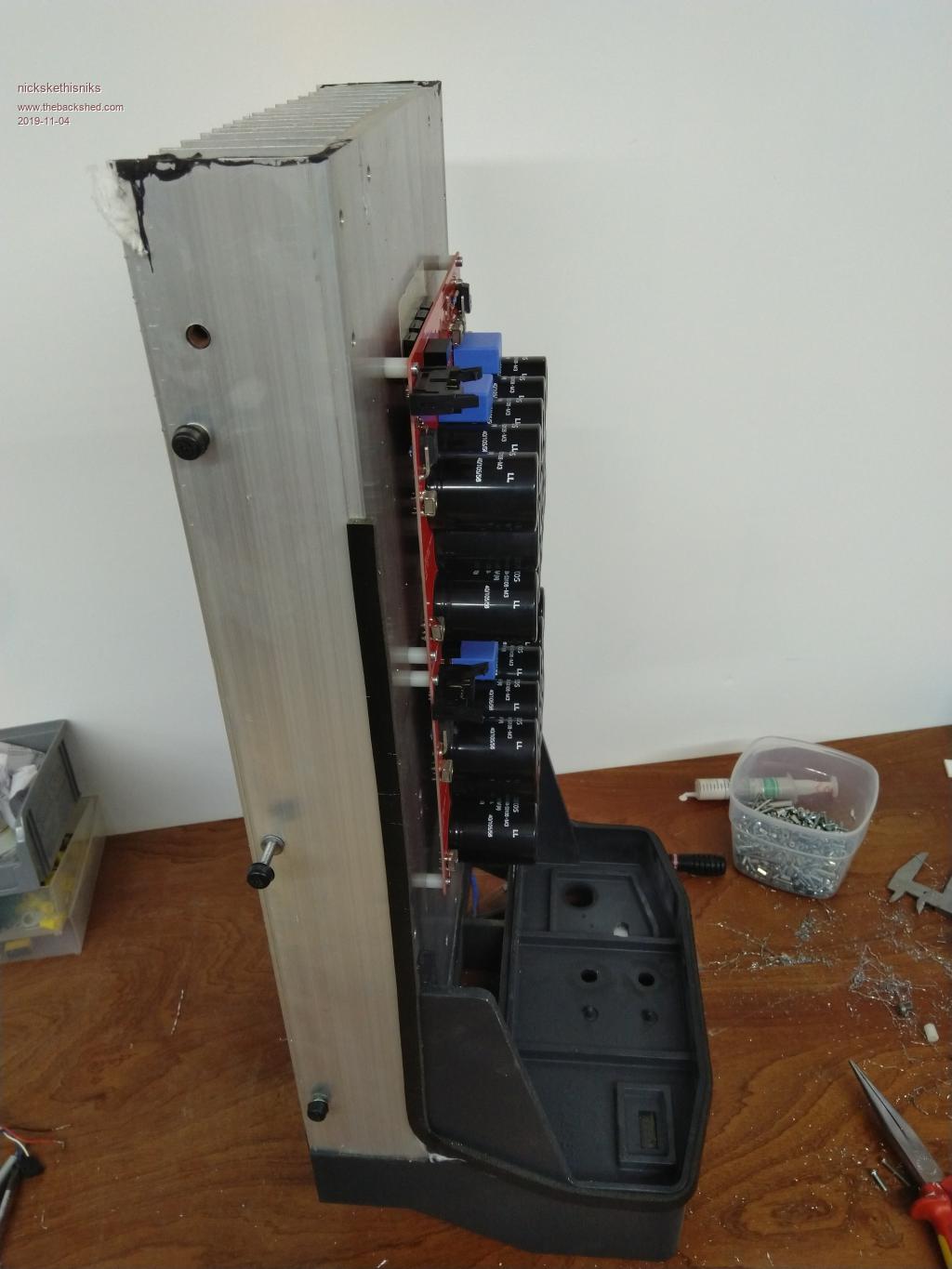

Since I want to keep everything safe for myself and others it will need an enclosure. So I thought why not using an old grid tie inverter for that.
It looks like the old casing will house 3 converters just fine.
So I will have inputs for 3 strings, and the outputs of the converters will be paralleled after a series schottky diode. Maybe I put in a fuse on the output, the solarstrings are allready fused.
The heatsink is about 32*54*6 cm so there will be no active ventilation needed, de  pcb I made has solderpads to connect 2 Ntc's for tracking the heatsink and inductor temperature. The µc controller can act when there are things out of range.
The inductors will be placed on top of the capacitors. I hate this part of a project, spent hours to drill an tap those holes.
It's verry hard to finish projects, I hope I could get this job done.
Edited 2019-11-04 06:59 by nickskethisniks

Posted: 09:11am 07 Nov 2019
Well, I got sick the other day. My body is empty, pushed it to far I geuess. It was a hard year, so I need to throtle back somehow the coming weeks/months. This week I took a few days of and next week my parental leave (2w) starts. I will become a dad for the first time, my wife was calculated for the the second of november...
So back to the project, the breakers are just for reference, I need to buy the right values. Thinking about it now, it would have been better to place one after each converter.
Saved by the sun today, we had 6 days of really clouded days in a row. So the lifepo4 were as close to empty @ 3V/cell. Can't estimate the level of the lead acid ones @2V/cell. I think we know more after this month. Today we will do break even, better days to come they say.
Maybe next week I will have a play with a rpi to see if I can monitor my system on a easy way.
Edited 2019-11-07 23:20 by nickskethisniks

BTW, Do I spot a 3d printed former
Andrew

Yes that's a 3D printed former, a colleague of mine has one. I bought those big ferrite cores, but couldn't find the formers. I'm going to build a new series inductor for my ozinverter.

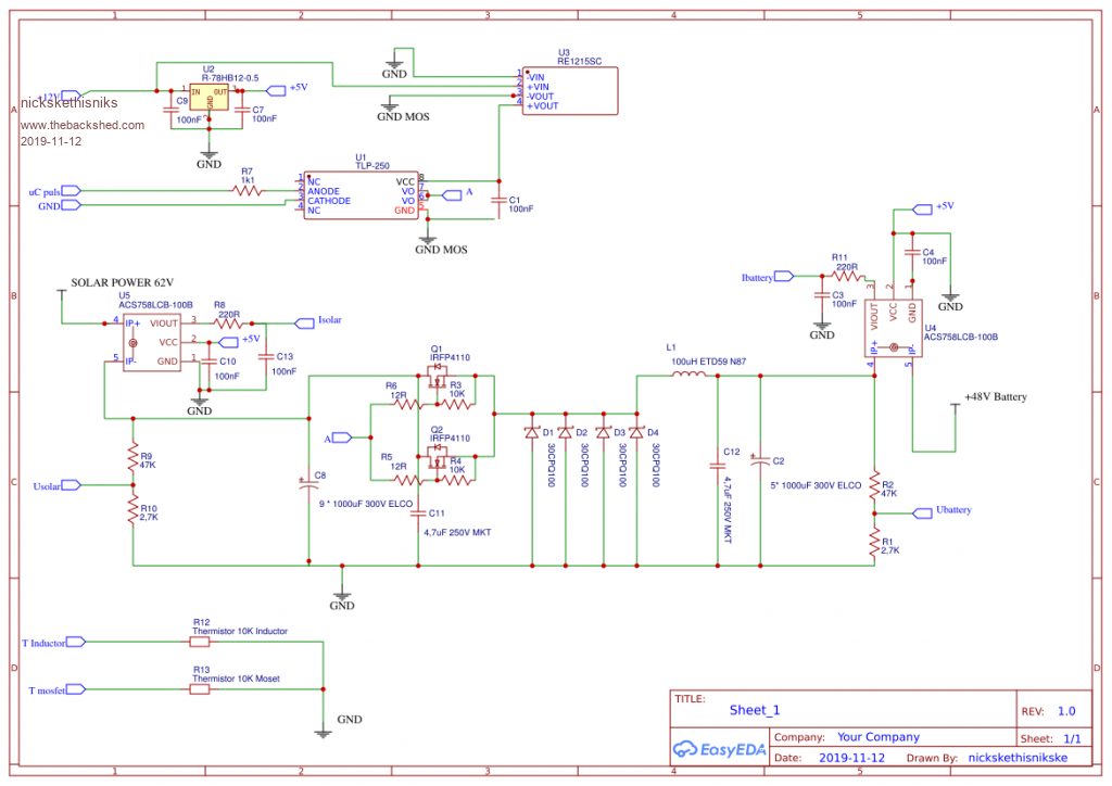

I made a schematic, normally I just do it on paper, it's faster that way, but I need to do it more in the future. For more complex pcb's there's no other way...
I didn't used parallel diodes on my gate resistors, and no snubbers on diodes and mosfets. I don't think they are needed, mosfets and diodes are overrated for my use (48V 30A).
With some inductors I experimented with, there were some really nasty spikes on my input and output capacitors. But ones the inductor was well designed (overdimensioned maybe) they were as close to zero.
This one for example worked verry good, but gave a lot of high spikes:
https://www.tme.eu/be/nl/details/dtmss-47_0.10_30-v/ringvormige-smoorspoelen/feryster/
I had it for a half year in a test rig, maybe it would be better with higher frequencies.
Not sure about all the values, the filter on the ouput of the current measuring is not tested.
All measured values are going in a differential amplifier before they are going in the uC. There was something about the outputcurrent of a µC, about sinking and sourcing capability.  It could be important when driving an optocoupler @ high speed.

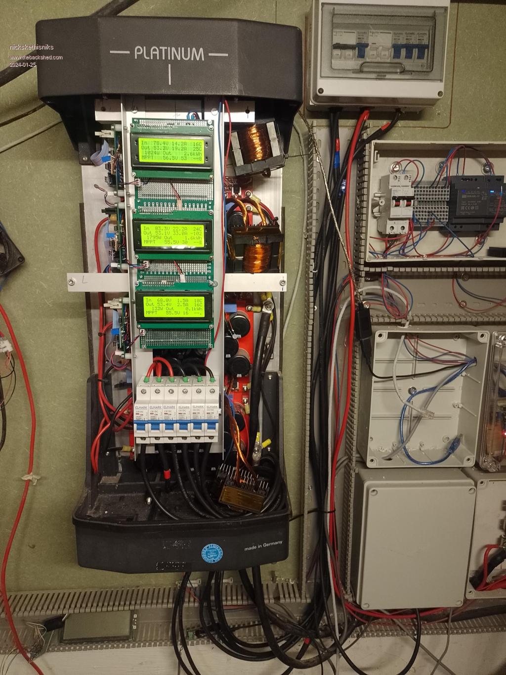

Posted: 01:33pm 17 Feb 2020
The prototype version is still going strong, but I still need to draw the controller pcb.
Today I saw 84A peak, good for more then 4600Watts in to the battery!
The unit is fused with a 63A breaker so it allows this kind of peaks.
I must say the inductor is cooled actively, at this kind of power it gets hot, +/-90°C.
And important, the tracks are short but the board is only 1oz thick, so the pcb is getting hot as well.
The unit is now running allmost 2,5 months without problems. There is 5600W panels connected. The final install will be verry conservative @ 40A max per unit.
Edited 2020-02-17 23:40 by nickskethisniks

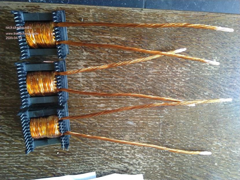

Posted: 10:32am 19 Apr 2020
Thank you Tony,
Well it's a cloudy day so why not spamming on this forum.
Picture of the 3 new inductors, 40 wires parallel for 40A. It's now 1,8mH but the airgap needs to be adjusted for higher saturation point and the right inductance.

  nickskethisniks said   It's now 1,8mH but the airgap needs to be adjusted for higher saturation point and the right inductance.
The rule of thumb way of arriving at an optimum gap is to monitor the ripple current at full load.
If the gap is way too large, you lose too much inductance, and ripple current will be high.
If the gap is too small, it will saturate, and again ripple current will be high.
Optimum gap will produce a definite minimum of ripple current, which you can find experimentally fairly easily.
That will produce the highest dynamic inductance under the exact conditions under which it operates in the real world.
Theory can only steer you in the right direction, the real proof is in the final testing.

The pcb was drawn with EasyEDA,
I know it's a chaotic post, I will give more details like schematic, gerbers if wanted and code next time.
I'm happy with the result that's why I want to share it with you guys! Any help how I could improve it is welcome!

A lot has happend since the initial start of this project, a lot of people are building these (improved) units with great succes.
So trigered by peoples strong start of the year I was thinking to give this a small update.
I wanted to build a triple unit to manage my solar input on a safe way, the original concept worked so great I never bothered to finish my triple unit untill recently I've made some progress and put it in service.
It's not yet finished and I'm allready thinking of a new design but I hope to finish this little one with some minor changes.
Problems with these are:
-Not repair friendly, a lot is on top of eachother
-Some board are proto and not really a proper pcb
-NTC's on the right place
-no fuses on the output, except the main fuse
-etc
I did add external ref voltage and a mosfetdriver to each poida controller board to make 12V pulses to the mppt powerboards. It looked more robust and buffers the 5V signal of the arduino.
I've also increased my solar power since then so I need to build some extra units. I like to run these without active cooling.
In the pipeline is a little and a bigger BOOST converter version of the original buck powerboard, TBC..
The power output is combined by 3 diodes wich are optional and increase the losses a bit, but I'm feeling safer this way for now.
