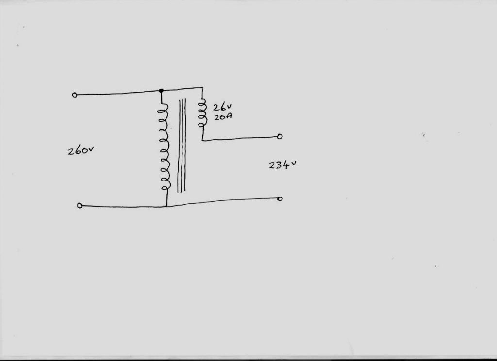

Posted: 01:22am 07 Aug 2019
O/k Dave.
Suppose your mains voltage is 262 volts, and you want to drop that down to say 250v.
You find a transformer that has a 12v secondary winding on it.
You then connect the high current secondary in SERIES with one side of the incoming 262v on the primary.
Depending which way around the secondary is connected, that 12v is either going to add to the 262v or subtract from the 262v.
Now the really nice thing about this, is that if the secondary is rated to carry 10 amps, you can draw ten amps from the whole thing.
So in this example if the transformer had a 12v 10 amp secondary, it will convert 262 volts to 250 volts at up to the full ten amps.
If you have a few big trannies with output voltages between about 12v and 24v, give it a try
Posted: 01:26am 07 Aug 2019
Connect this between your grid tie inverter and where it plugs into the mains.
The grid tie inverter will always see a voltage less than is on the mains, regardless of which way power is flowing.
Davo99
Joined: 03/06/2019
Posts: 1586
Posted: 11:53am 07 Aug 2019
Geez this makes me feel dumb.
Let me see if I have got it right in my head....
One side of AC goes to a secondary ( low) side. Other low side goes to the inverter.
Other AC side goes straight to inverter with the AC side of the transformer tapped in.
Is that correct? Your diagram doesn't have the dot / circle on the straight through AC side but I assume that's what you meant as it couldn't be unconnected?
I'm really hoping those Trannys I have up the back somewhere are suitable. They are Big heavy things about half the size of a house brick but I have no idea the ratings. Mate said he was going to do a guitar amp out of them and I -think- they may have been 24V but somehow I also seem to recall a figure of 60V.
Looking on fleabay I'm almost wondering if " Transformer" is the right word to use still. I assume I'm looking for those lumps of metal cores with 2 sets of windings in the traditional configuration?
A search on fleabay for transformers gets about 95 switch mode power supplies and about 5 ( relatively) of the type I'm looking for. All in pretty low ratings. There are also a few toroids again of pretty Diminutive outputs on the low side.
These traditional transformers must really have gone out of fashion!

Posted: 09:13pm 07 Aug 2019
A bit of experimentation with a multimeter should tell you which way around the secondary needs to be connected.
It probably does not need to drop the voltage by much, 12v or 15v might be enough.
