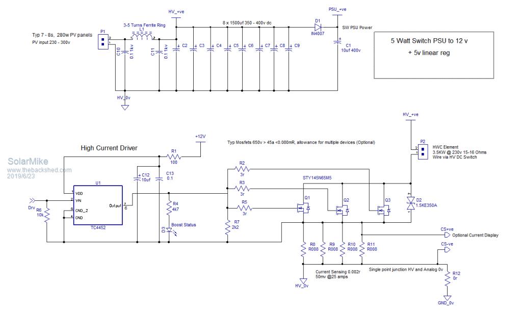

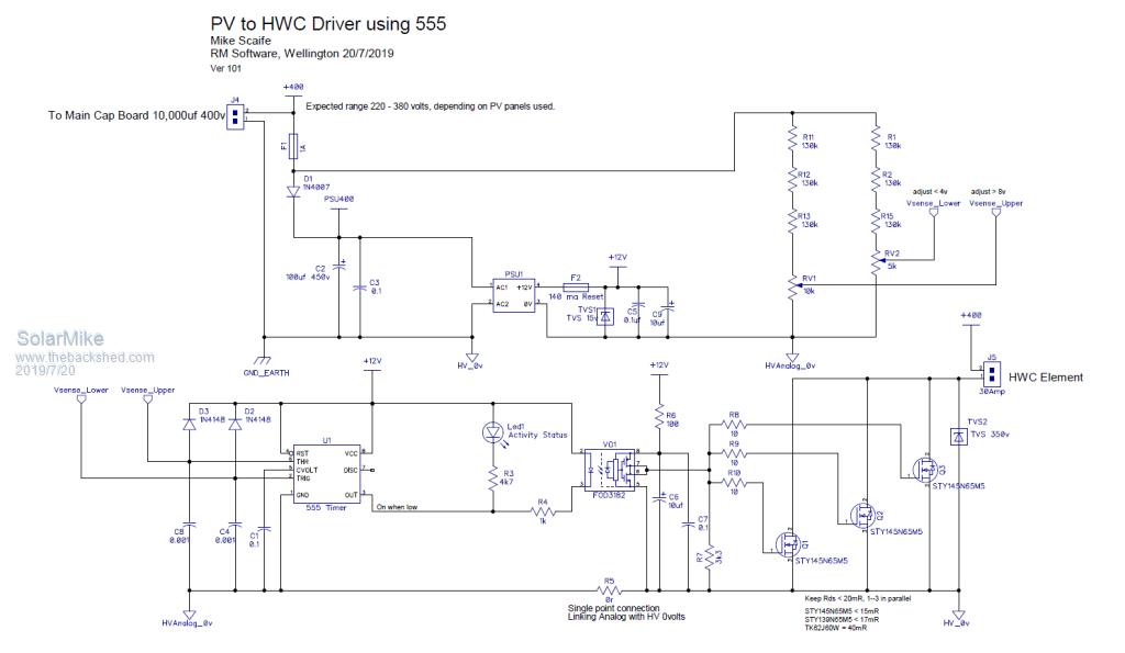

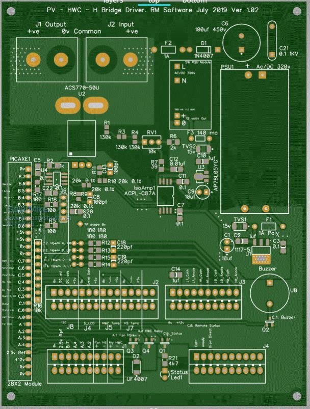

Moved this design to a new topic for discussion.
The original question was could something be cobbled together from off the shelf components to power a 16R 3.6 Kw hot water element from a high voltage PV array, comprising 8 PV panels each with a Vmp of 30 volts and current 8.5 amps or so.
Perhaps for low power\voltage with a 50v element, but nothing otherwise readily available, so we have to design it.
The HWC element can draw max of 15 amps @240 volts, the 8 pv panels above, output 240v, but don't have the current capacity to drive the element without collapsing the array voltage.
Warp has done some valuable measurements at various loads on a PV panel to prove there is a broad enough power output peak from the panel to allow a simple voltage switch to charge up a capacitor bank to the Vmp voltage and discharge using one or more mosfets into the element resistance, as the bank voltage drops to a lower threshold point, the switch is opened, allowing the bank to recharge. The process repeats at a rate determined by the size of the capacitor storage and the energy from the PV, with approx 10,000uf the frequency is around 50-100 Hz, there is a dead time in the process as the bank recharges, this suggests that this MAY provide enough off time to stop any arcs created when a thermostat opens; Note this has not been tested, so proceed at your own risk here.
This process can be used on bigger arrays, however there reaches a point where the PV output is greater than demand from the element, where the switch will always remain on and have no dead time to stop contact destroying arcs forming on the thermostat contacts when they open. To allow more dead time the series PV voltage can be raised eg 10 series panels Vmp approx 330v (high power panels typ 33-36vmp); the higher voltage will allow higher current pulses into the element thus extending recharge dead time. Dangerous scary voltages, so proceed at your own risk here.
This first part of the circuit shows the capacitor bank and the mosfets, I have allowed for 1-3 parallel mosfets here, the one specified is very cheap on AliExpress and no doubt a clone, however 3 may work ok, will see... but you want < 50mR resistance to keep losses to a minimum. The 0.002R source resistor is to allow a current sense for display on a LCD screen along with power etc should you want to add a CPU to the mix. The 12v power to run everything is one of those cheap 230ac to 12v 5 watt switching PSU's, it will run OK from the high voltage DC. Note the 0v line is connected to the high voltage DC, so keep everything well insulated behind perspex etc. It is possible to completely isolate the low power driver and control from the HV, but will make the design more complex.

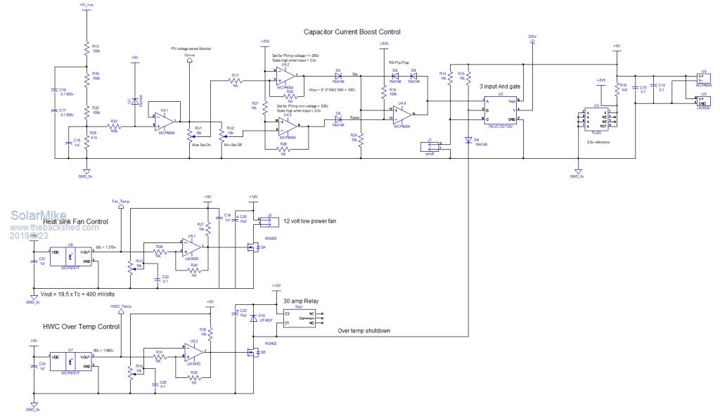

Controller side has a rail/rail op amp acting as a comparator and RS flip flop to allow independent setting of high\low capacitor bank voltage switch points, place them 10 volts or so apart to start with.
Optionally not absolutely necessary is a heat sink sensor to turn on a small 12 volt fan for cooling and a hot water temperature sensor to disable the power into the element, I would suggest this be set lower than the fitted mechanical thermostat in the HWC, this adds some redundancy to the circuit should a thermostat fail with perhaps disastrous consequences.
Sensors used are the MCP9701T TO92, they are a linear thermistor with a buffer stage, may be tricky to properly insulate them.

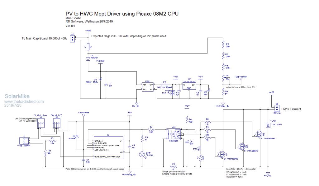

I am rather interested in studying this a bit closer, as it seems I can use this for a Max 6KW heatbank system with two elements. Presently only run on one element 240V Mains but it seems there is merit in installing the second element again but driving this with solar panels.
I am also eying off my hot water system running on a 500W element at the moment (accidental as it should be 1500W but was not available when I needed it then forgot to about the smaller element for a number of years and just discovered)
The capacitor-boost schematic is very fuzzy on my pc and even the picture itself when I try to magnify is a bit hard on my old eyes.
Any chance your system can produce a pdf version, that normally overcome resolution problems.

  plover said  Any chance your system can produce a pdf version, that normally overcome resolution problems.
No problem 2019-06-24_065938_HWC_Schematic.pdf

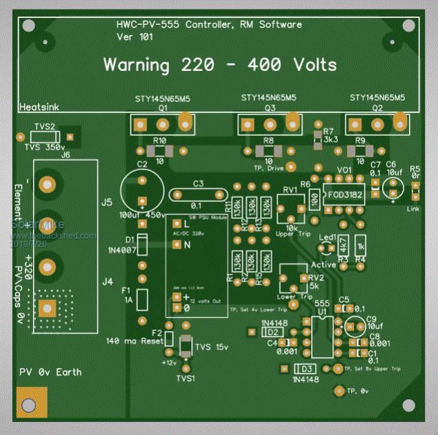

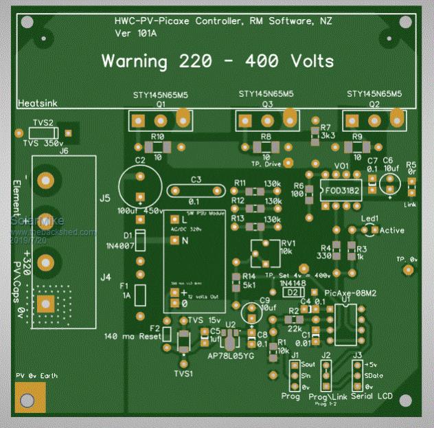

I have ordered some of the items for this, soon as they arrive will start on a pcb design; will post the gerbers here.

Would you be interested in making some of these boards to sell Mike?
Solar Mike
Joined: 08/02/2015
Posts: 1255
Posted: 09:05pm 24 Jun 2019
I will be posting the gerbers, anyone can get them made, guess problem being there is a minimum quantity per order from likes of JLPBC of 5. Postage usually costs about same as the order, so may not be cost effective for me to sell them. Will see once its been sorted and running.
