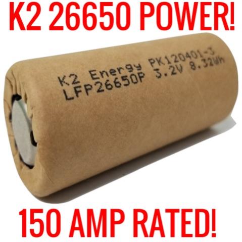

Posted: 06:09pm 16 Feb 2019
for those in the US.
The battery hookup has some 26650 lifepo4 cells for sale
the voltages of 4 series cells is well matched to 12 volt.
you could fit balance wires to fit a hobby charger or something standalone from knacro or jiller
my best estimate is this is 30% cheaper than retail for larger prizmatic cells however the hassle and expense of pack building means it really is only viable for something small.
still would be handy for tinkering.
