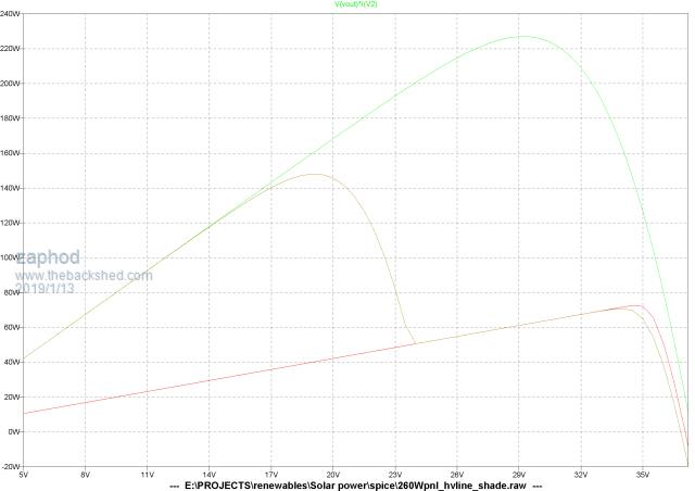

Thank you so much Aaron, I have no sun at the moment or at least not enough to show a shadow so I tried simulating it instead, here is the output of a single panel with first no shading, then one row of 6 then one row of 10 cells the shading factor being *0.25). When the shading diodes are active (10 cells shaded) the output has the classic twin peak mpp's (140 & 70W) that some controllers )including I suspect mine) get confused by (they latch onto the wrong peak).
I apologize for the poor image quality this is a bit of problem when printing plots from LTspice.

Ok I see how that works, Looks like long strings (grid tie systems) would have more issues than these short low voltage strings, with shading.
The test I did the other day was just on one panel of a 2 panel string running on PWM (3 string's on that CC).

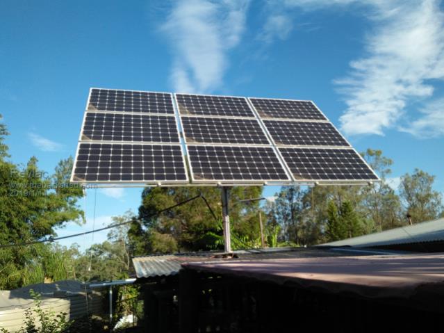

So I had another go today late afternoon, this setup is pole mounted (250W panels) MPPT Charger and has 3 horizontal strings, the idea at the time to make it this way was because the big trees across the road would shade the bottom row late afternoon and progressively shade further up.
Still can't tell if the Diodes are doing anything.
The current reading on the bottom set of panels was down somewhat compared to the middle row when partly shaded, as expected, But before and after this the MPPT remained at 100 volt total string voltage, once the top row stated to get shaded the voltage drops to around 75v, getting dark
I would expect that the charger stayed on the high voltage string for the max power point, However I think this would be different If I was using all the power available.
Had plenty of power anyway and a bit of shading late afternoon has not been an issue as it is dark in about half an hour.
In this case short string's low voltage was the better option, I think, and I'm happy with the way its working.
Hope I haven't mist the point.

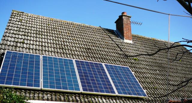

Woww impressive picture, in this horrible police state someone would nab me for sure for having a pole mount like that, we are only allowed flat to the roof or ground mount on the ground :(
Anyway I noticed the letters PWM & CC in your reply, could this be doing battery charging ? It might be possible according to your load and controller indeed you would not see any difference.
Here is a pic of my minimalist array mounted in the prescribed manner :)
And thank you again for your help :)
