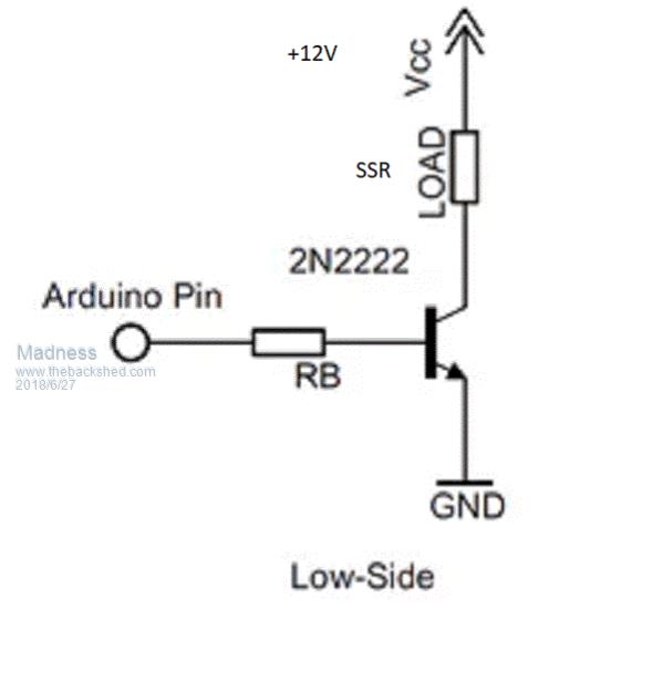

Phil you can drop back the power consumed by the 3.6KW element by putting a motor run capacitor in series with the AC L connection. You will have to play around with values.
The following Arduino code works well with my regulator to divert excess power across to the HWS. The resulting PWM output needs to be stepped up to 12V which can easily be done with a 2n2222 transistor on the low side to drive a 25A AC SSR.
if (vin > (Setpoint - 0.2))
hwval = (hwval + 4);
if (vin < (Setpoint - 0.4))
hwval = (hwval - 14);
hwval = constrain(hwval, 0, 255);
analogWrite (PWMHW, hwval);

Posted: 10:47pm 26 Jun 2018
George are you trying to get a 0 export by diverting all the power to the HWS from your GTI?

Ha, Didn't even see your post when I wrote mine mad.
No, Not trying to divert it all for 0 export although I do have a practical need for that with something else and I have been trying to find a device to do it.
Everything so far seems to control an inverter where I want something that could divert or switch off any source.
With the heater, just trying to look for something that is more automated.
Today for instance is cloudy and there will be little output but yesterday I could have probably fed 2.5 KW to the heater instead of 1.5. other days may only allow 500W. As well as the water heater, in winter it would be great to have something I could also use to divert varying power to something like a simple bar heater in the house. With such a devise I could use the excess power I have and if I put on the Jug I'd not be drawing from the grid because the devise would sense the lower line voltage and throttle the heater back or shut it off.
Seems a simple thing but very hard to find... if they are even made.
Seems a lot of things like this that could be applied to solar regulation just don't exist when I'm sure they would be dead easy to make.
I was thinking of something that monitored the Line Voltage and kept that at a threshold. The more input the GTI's make the higher the line voltage so if I had something like the Voltage monitor that sensed that and then fed in more power as the line voltage limit allowed, that would be it. Something like what GTI does with loading panels.
For the zero backfeed, I have an electronic metered phase in my meter box which I can't back feed. The age of the meter detects that as a reversal and attempt to steal power so registers a charge both ways. I'd like to be able to connect a GTI to that so I can supply the house loads connected without charging myself for the power I supply.
