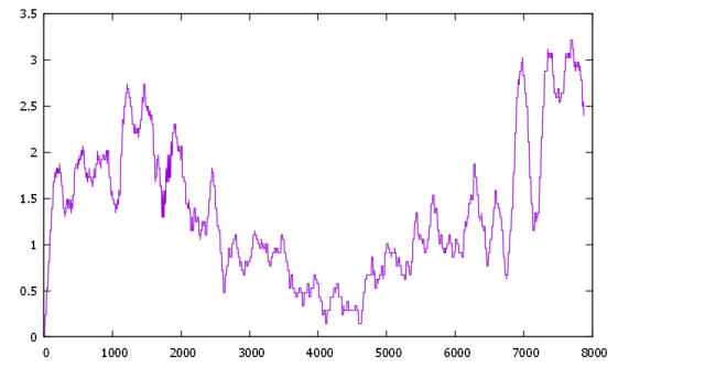

Hi All, 1st post here so I hope the image works! This is the output of my 1Kwp system here in the UK at Lat52n
Vertical axis is average Kwh/day, horizontal is hours so data is for the last 11 months. Winter here is December to Feb!
I should add this is a DIY system (except the panels) and is mainly used for water heating with whatever is left over consumed by the house, nothing is exported!

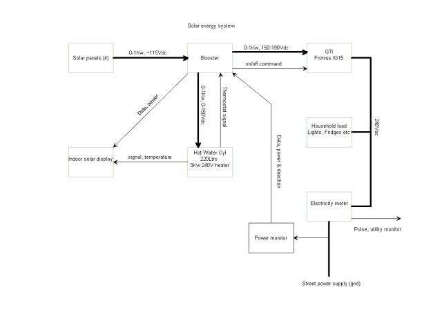

Here is a system diagram of the solar system at the moment, I drew it for my wife :)
Here in the UK older houses like this one have an insulated hot water storage cylinder fitted with an electric heater in case the boiler/furnace fails and that is how I heat the hot water from PV.

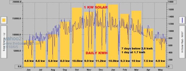

Yahoo, am I reading that graph correct? Your average daily kwhr for dec is 11.2?
That seems very low for a full days production in summer, is it a small system?

Hi Mark, these numbers was extrapolated from 3 fancy 320 watt LG panels I had for testing so it is a fraction over 1 kw. What I didn't realise when I had them was they are bi-facial, I think I could have squeezed quite a bit more out of them with the right mounts and a better reflective surface underneath.
pretty sure I wrote "per kw" or something like that on the graph, I should have saved it as a gif, I didn't think it would be quite that small as a jpeg.Edited by yahoo2 2018-06-07

Yahoo2, I like your fancy graph .
What kind of gear would I require to record something like this?
I have no smart inverters, just the home built ones and
5Kw of mostly second hand panels. All solar power goes to battery charging, no grid exporting.
Unfortunately I did not get a keyboard & mouse for my first birthday, they were not even thought of back then.
So something plug in and with minimal 'fiddling' would be ideal .
Or am I just wishful thinking?

Yeah probably, its not actually on a real system, it is an old mobile test bench a group of us used for checking the quality of the panels we were buying and to use as a benchmark against a newly installed system. I hacked a datalogger into a davis weather station so it would transfer it to a computer with weather data that matched.
it is pretty clunky, I usually just export to excel or libreoffice calc. i am trialing a thing called Grafana for some home automation gear, I still haven't got my head around the database management but it looks OK.
The problem with working systems is there are losses, someone made us a motorised auto adjusting load that supposedly holds the max power point continuously. Very fiddly to calibrate.

Stats are difficult if you want to do them over a long period because you have to choose a lasting record format, in my case early on I developed a logger seperate from the converter releving the latter from all responsability except spitting out its current power at ~1hZ serially.
The logger (that consumes <100mW) counts up these spits with the aid of an accurate real time clock and accumalates them in a 32Kx8 serial EEPROM hourly, this along with the tank temperature produces a massive file that I dump to a PC maybe bi-monthly in ASCII.
From there it's massaged in C using Cygwin from where it eventually gets plotted using Gnuplot that can be persuaded to produce various output file formats such as png rendered here! There are sites like https://www.pvoutput.org/ to compare your output to others if you can be bothered to massage your figures to there format and it just seems an ego trip for californians to prove they can outdoo everybody else
PS my data is real Edited by zaphod 2018-06-08
