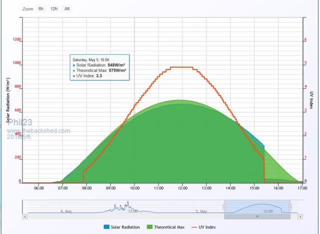

I'm assuming that's about right for this time of year considering my weather station gives the 10:00am theoretical Max as about 575W/m² for the day.

It was mentioned I should get more, but the facts above don't add up to that, particularly the irradiance reading.

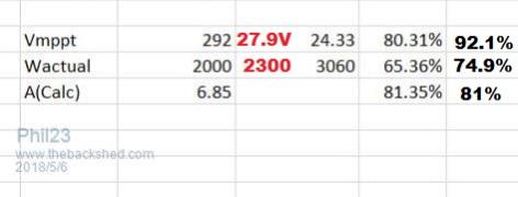

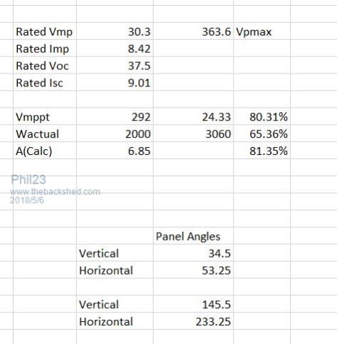

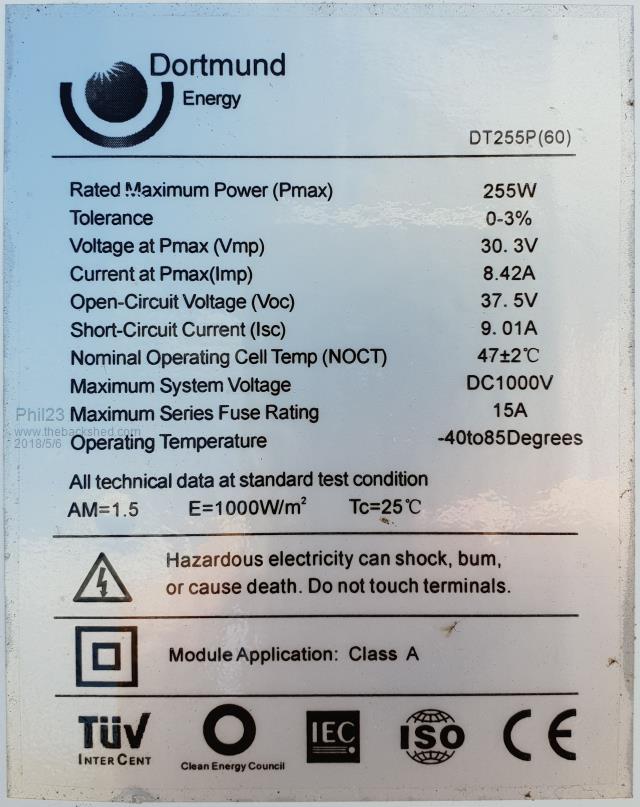

These are the panel in question.
These are the actuals, so average panel voltage was 24.33V & current 6.85A.
I live in the real world, and don't expect the true test spec values, so presume all is Ok.
Phil.

  Madness said  If you can get the full specs of your panels you will be able to get a better indication of what you should expect.
Gotta just love those days when Google doesn't give you a hard time.....
Easy find...
255W panels.
Phil.

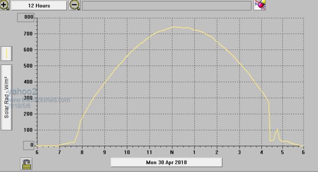

I am at 33 deg south and this is my solar insolence with a vertical sensor.
that tallies with your amps quite closely, looking at the graph in the data sheet I think you are probably 3.58 volt per panel down on your voltage theoretical max. Some of that might be mppt losses, the rest could be a combination of things.

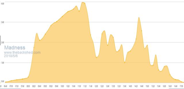

Here is mine with 2 X 3.5KW, these panels are laying flat, there is also shade until after 8AM.
There may have been a little throttling around midday with my GTI regulator.

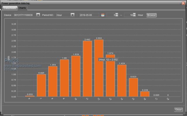

Posted: 10:10pm 06 May 2018
Not getting anything quite as impressive as above; probably a lot to do with the fact that one string faces SW; the best option I have for it.
Don't go much on my monitoring software, very buggy & supposedly identical installs behave completely different in terms of the data layout they display.

Posted: 10:32pm 06 May 2018
2.5KW from 3KW of PV is not bad.

Pete Locke
Joined: 26/06/2013
Posts: 186
Posted: 05:04am 07 May 2018
Love the name plate. "Hazardous Electricity Can shock, bum, or cause death"
Sorry...small things
Posted: 05:24am 07 May 2018
LOL, I missed that, a bum may be quite shocking.
