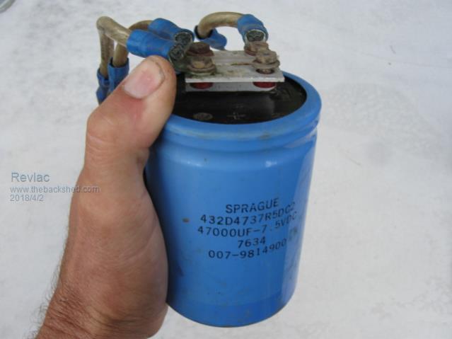

There are two fundamentally different types of ultra capacitors.
The cheap ones are only designed to provide very low current for a very long time, for example for RAM memory backup. They are meant as a battery replacement and are more suitable than a battery for some things.
The more expensive ones are true power capacitors that can deliver huge short term current. They are large, heavy and expensive.
You can usually tell the difference by the connections. The memory backup capacitors have frail legs, the power capacitors use a bolt and a threaded hole.

Power capacitor, This should meet the description of a power capacitor.
Found it in the shed in a box full of other large one's, bit of a collection over the years.
Cheers Aaron

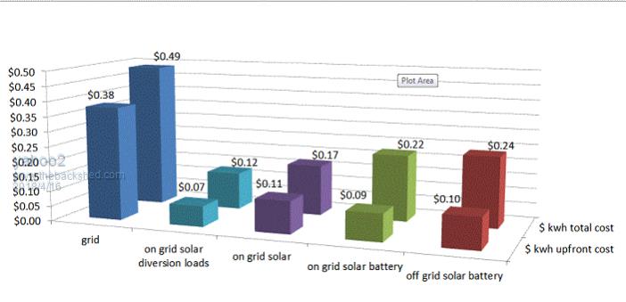

i can share my numbers with you, for a 6kw system with every tweak i can do these are the costs upfront and over ten years.
You can see that the battery investment increases the financial costs over 10 years, from memory this was using 7kw per night from a 10kwh lithium bank that cost around AU$6000.
so if the benchmark is grid solar @ 17 cents then diverting power saves you 30% and storing power costs you 30% extra.
Bear in mind these numbers are cut to the bone for the perfect large customer. I have seen costs blow out from triple to ten times these numbers.
I guess the question is, where do you think a small battery and capacitors would come in that list?
I have priced used Maxwell supercaps including freight and balance boards I am looking at around $2400 before I value my time. If we pair this with a 2.5 kwh battery pack we save about $1800-$2100 in capital costs but we add less than 100 watthours to our storage capacity. So we have to buy around 5kwh of energy per night (roughly $2.50). So plus energy cost minus capital on batteries over ten years I think it would be close to 24.1 cents. Edit: my envelope math was wrong I have changed it.
