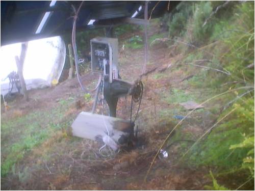

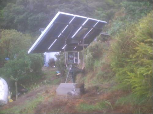

Posted: 11:43pm 07 May 2008
Hi
I have more less this system driving. Car Diff Wiper motor, Panels mounted on old steel bed frame.
Motor drives panels round to set tilt bed frames free to pivot and offset rod gives steeper tilt morming and evening as panels move round.
control at the moment is via timers more less as above. This i only considered a quick easy method about 3 years ago. My plan is to fit two detectors in such a way that one will be lower in value if sun is not shinning straight down. this would start timer driving motor say 10 sec then stop repeat after a time if the forward cell is not getting brightest sun . this would only drive forward until either limit switch or if dark is detected then drive motor would reverse until back at morning position. no worries about hunting as only drives one way under control. sounds complicated but electronics simple.
