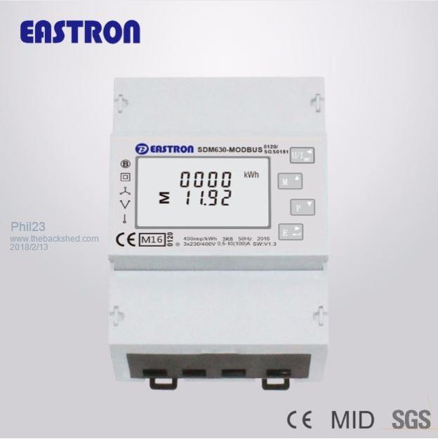

Just wondering about 3 phase energy meters and whether they could be treated as 3 channel meters on single phase.
Some have external CT's while others loop Active thru the device.
Get the impression they should work, particularly the CT ones, as long as the fact that the 3 CT's being phase sync'd is not an issue.
Presume some phase/PF readings might be wrong but basic load per phase should be ok????
One with CT's.
One with Direct Connection.
Phil.

I have a single phase version on its way that is the same brand with modbus like the bottom one above. You would be able to get current and voltage reading for each phase, if the meter does not like it all being the same phase you could do what you want with the data on a computer.
I have ordered a single phase one to work in with my Zeversolar GTI's (via Zevercom device), it will even allow controlling the GTI's export. I will set it up so the inverter/batteries are the grid, I can then add multiple GTI's with as many panels as I want and always be able to keep the back feed via the inverter to level that the inverter is okay with. At least that is what the manuals tell me it will do.

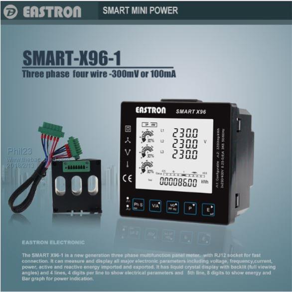

Just decided to have a look at the manuals for these.
It appears that they may be able to be configured for single phase.
I get the impression that would mean monitoring 3 separate circuits.
Manual is a bit washy, but mentions it on Page 10,
"to select the required system option: 1P2(W), 3P33P33P3(W) ,3P43P43P4(W)".
If it is the case & it can monitor 3 individual circuits, it would make a great data logging device in CT form, when combined with a Micro.
Phil.

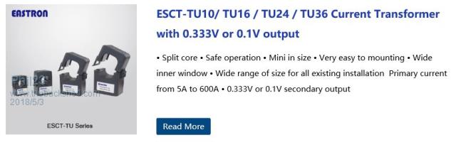

Edit,
With these CT's, not the one above.

They don't give away much, who knows what the software in it will do. Three of these would be the safer way to go.Edited by Madness 2018-05-04

Yeah,
Guaranteed to work.
Appeal in the other is that when I can request a big chunk of data to get all live readings (As I'm doing with the SDM220's), but the response returned has 0's in every 4 out of six bytes, that's where the other phases data belongs.
With 14 circuits leaving my meter box, a single device with 3 CT's would be a nice easy option to log some data 3 circuits at a time.
Might search a bit more & see if it's worth taking a punt.
$150 punt though for maybe one like this.
Phil.
