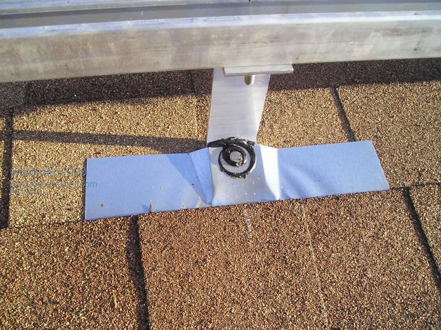

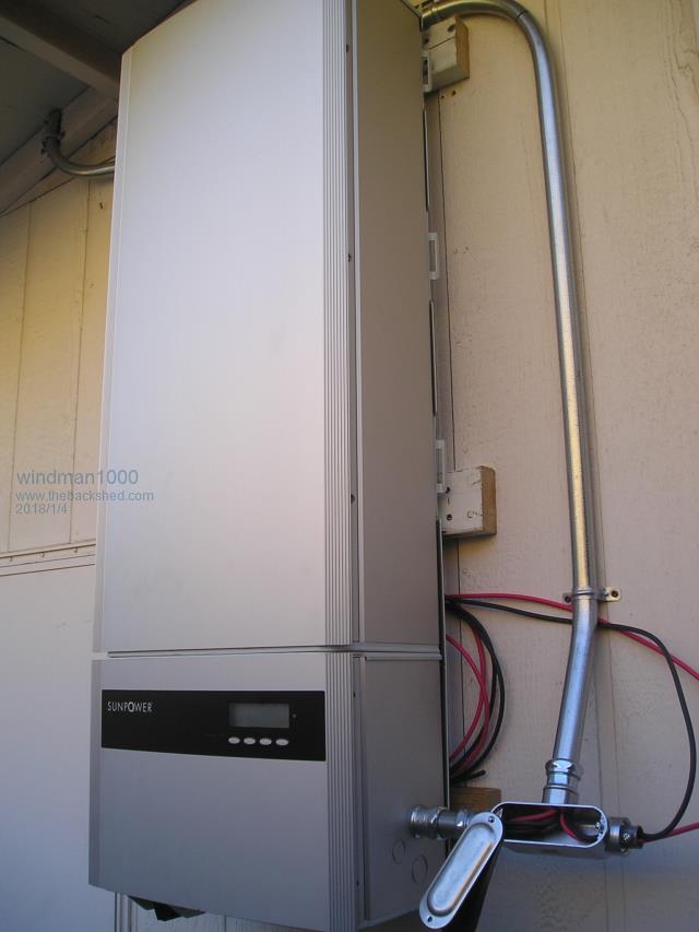

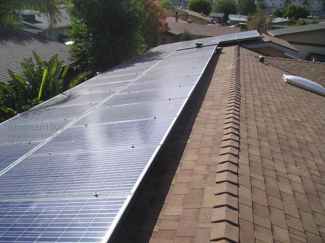

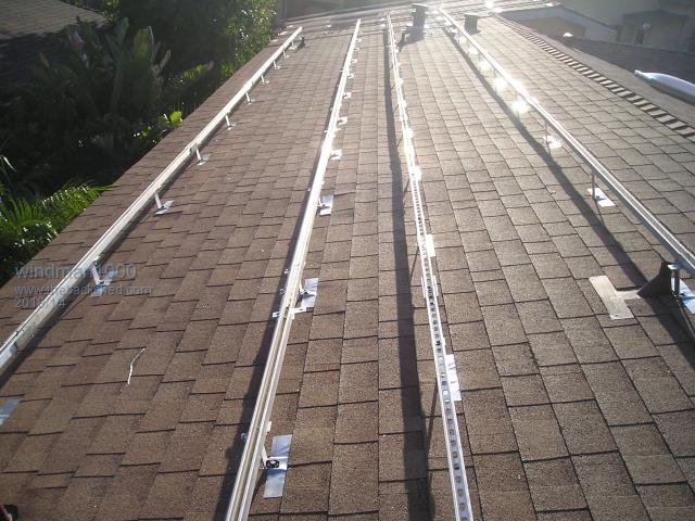

I Ran into a good deal on this 10k system ( 40 New panels 250 watt 75.00 each 3.000 total)
And found my 10k sunpower grid tie inverter for 1200.00 off of ebay, aluminum Uni-Rak for my rails 400.
I have about 5500.00 total in this 10k system, And I put It In to code but didnt permit it , So im trying to get the most out of it.
