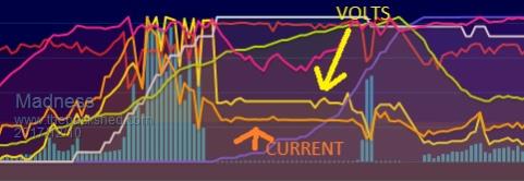

Here is what my battery current and voltage looks like with the regulated GTI operating. The graph is one complete day, the dips in volts and current are caused by clouds/heavy loads on the inverter. The light blue vertical bars are the power output of one of my Midnite charge controllers, it is not putting any power out when the battery is on float as the GTI is powering everything then.

What may not be obvious to most people, is that a sine wave inverter always draws a heavily pulsing current from its dc power source.
During the ac zero crossings, the inverter input power effectively falls to almost zero, and rises to a massive peak at each crest of each ac cycle.
If the power source is from a massive battery, that is not much of a problem.
But a solar panel is a VERY load sensitive current source.
As soon as you start drawing any significant current, the solar panel voltage falls away significantly.
There is absolutely no short term overload capacity from a bare solar panel.
All grid tie inverters will have large electrolytic capacitors fitted directly across the dc supply from the solar panels. Cost saving being what it is, these may be be made miserably small. There may be some worthwhile gains in adding extra capacitance externally between the solar panels and the grid tie inverter, although the point of diminishing returns applies.
As Mr Hotwater has quite rightly pointed out, if you are going to introduce some kind of PWM power limiting control ahead of a grid tie inverter, the pulsing nature of the load needs some consideration. With the correct approach, I think there might be some really bright possibilities with this approach.
