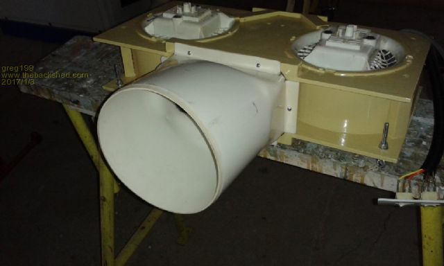

I've re built a 240V range hood exhaust fan system to exhaust the hot air from my shed ceiling space. This is it:
It has three different speeds and draws up to 200W. I'm considering buying a solar panel of about 250W, attach it directly to a suitable (inexpensive) inverter (12V DC to 240V AC) and run the exhaust fan directly from the inverter. It would only be used when it is hot and I could simply leave it ON all the time. Whenever the sun is heating up the shed it will also run the fan. Seems simple conceptually.
Three questions:
(1) will it work?
(2) any suggestion for an inverter that would do the job reliably (and without setting fire to the shed in my absence) ?
(2) I'm guessing the inverter may lose about 10% of its input wattage in the conversion. Is this about right?

Being that they are probably induction motors, you will probably want Pure Sine Wave.
300W may do it but 600 would be safer.
I've got a Projecta 600W for camping, Link, and have tried it on the freezer outside, 300l, and about 200-300 watts & it can't swing the compressor for startup; pulls the battery too low & causes an alarm state.
The induction motors should have an easier start-up though.
Are you intending to include a battery & some sort of charge regulator, as I'd expect the inverter will expect something like 12.2 to 14v & without a battery, current available could be all over the place.
Curious about the physical sizing & flow rates. 200mm fans?

... because I don't have any but I did have the range hood exhaust fans.
I don't have any way of measuring the air flow rate but they seemed to be pretty powerful for their size. After all, they are designed to exhaust air.
No, I did not plan to attach a battery and regulator. That would just add extra (and maybe unnecessary) cost and complication.
I'm keeping it real simple at the moment and wondered if any one else had tried a direct connection between solar panel, inverter and fan. It does not matter if it is not efficient since exhausting any hot air is better than nothing.
If the sun isn't shining and I'm desperate then I can simply plug the fan unit into the existing mains power (as I do now).
