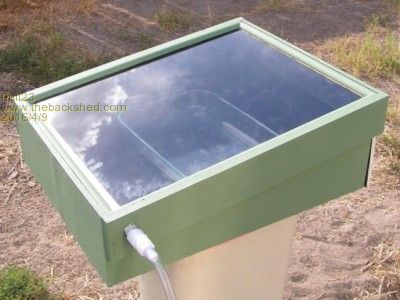

Hi Upwind,
Have you seen ideas like this?
Plenty of examples to Google & some performance tests on YouTube.
That one came from here.

  upwind said   Thanks Phil23, some good reading there. Am I right in thinking that to use the distilled water for batteries there should not be any metals in the system ?
I'd think aluminium for the drip tray would probably be Ok as aluminium has a tight oxide skin.
Don't think any normally makes it into the distilled water.
