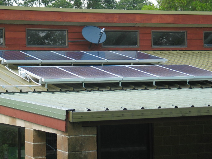

Hi guys a couple of pics of my 1.55KW system. 10x BP155 w panels connected 5 in series then two sets in parralel. Inverter is a Sunnyboy 1700w unit. So far it has rained for the whole two months since installation. We have still managed over 260KW hours, with a maximum of about 8.6 KWh in a day. Max output seen is 1770 W so the rumor that BP is down rating its panels to ensure compliance with their 12 year 90% performance guarantee seems true.
regards Robert
Edited by Robert_VK2BBR 2008-02-13
1555 W grid connect system since Jan 08

Posted: 12:00am 12 Feb 2008
Hi Robert,
can you please edit your photo. This problem still seems to occur, and the solution has been posted many times.
cheers.
