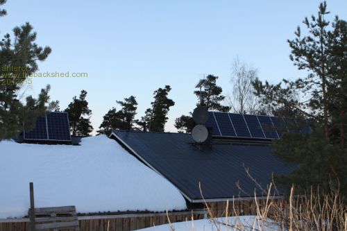

Solar collectors are history..
(they have plastic and rubber parts.. solar is eating them..)
YOU do not need any pipes, pumps, toxide fluids, pipe insulation, heat exchanger,
controllers, sensors etc etc
AND.. when the sun is shining, the full power bursts to the boiler,
floor heating etc without any loss !!
ALL you need is just, normal low-cost cables.

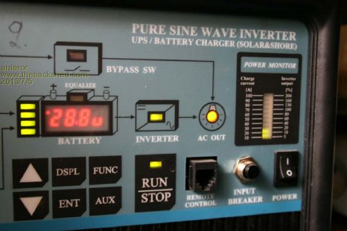

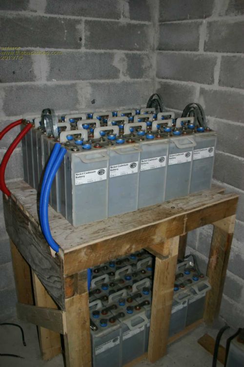

My systen with old ice braker NICAD batteries 2000Ah 24V;
My batteries, old ice braker ship batteries NICAD 2000Ah 24V.
My inverter, I have 2 of these Fraron 3kw and they have worked for
a long.. time for me !

Question on the first picture ... what is the right hand roof covered in? Or have you removed the snow from it? Or is there no insulation in it?
