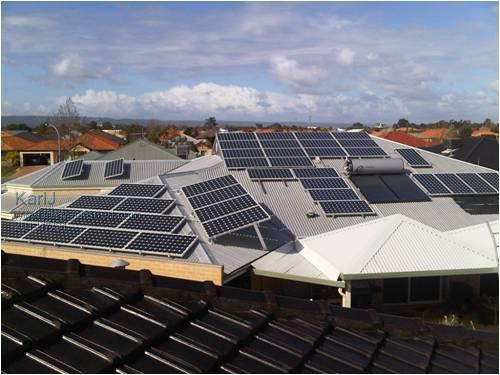

I have the roof
I'm in the right industry.....
why not!
http://forums.energymatters.com.au/resources/image/411
Still at 28 panels but by the end of the week it will be 40.
roughly 7.3kW for the sake of arguement.
Compromise is 2 strings of 12 panels on the 3000HF 1 string of 185W panels and the other of 180W panels.
I thought this was a better option than 190W panels as i'm already overpowering the inverters by a decent margin as we have a 5000W inverter limit over here in WA to get premium feed in tarrif.

all done
I did go for the 180W Solarfuns, hand picked a dozen at 183W a pop so close enough to the ZNShine panels that were 185 +/- 5%, possibly even better!
Certainly much less expensive than the suntechs and I didnt need those extra watts in any case.
Quite an awesome array of panels even if I do say so myself...
Today the weather is miserable but still cracking 400W....
yesterday with some full sun, both inverters top out and crack in 5300W continuously.
not much clip but fluctuating within 50W of MAX for both. I think this will be idea as previously in summer in the full heat of the day the CMS units barely made 1900W with 2.6kW panels, hence 2180W continuous is realistic with 3KW panels on it.
similarly the 4.4kW X 0.75 on the 3000HF =3285W less efficiency losses of 5% = 3120W and it tapps out at 3080W. so close enough!

No wonder it's getting cold up here in the north, your sucking up all the sun.
Impressive array Karl.

  Barry T Coles said   you're sucking up all the sun.
What's next Karl? A granny flat - or large garage?
Incidentally, you don't expect the panels near the HWS to provide unwanted shade?

The ones behind dont get any shade and the one to the side will cop a little late in the evening but no real solution to that.
Lower on the roof = shading from elsewhere.

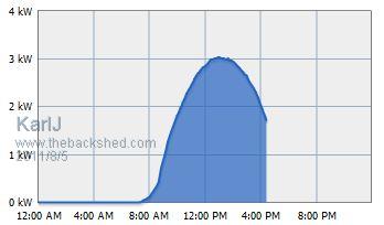

today was a classic example of why overpowering is good.
awesome. This graph represents 4.38kW / 7.34kW array on the 3000HF.
its more overpowered than the CMS 2000 (the CMS runs out to 2350W as opposed to the SMA 3000HF which is all out of ideas at 3076W)
In total the whole system made 32 units today and fed 29 of those to the grid Edited by KarlJ 2011-08-06
