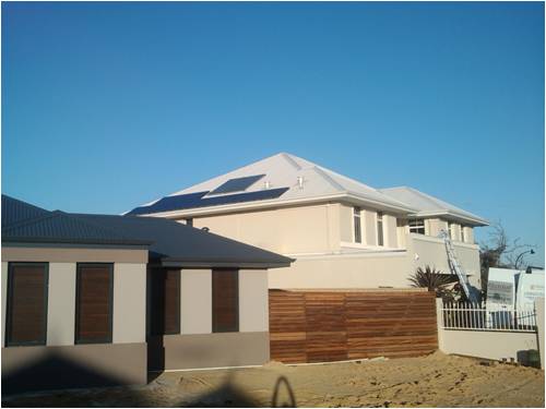

I got my 5.2KW array signed off for $500.
here is some eye candy from I job I did on the weekend.
5 different mobs said it couldnt be done yet here it is.
took me a whole day and I spent $600 on a harness to do it.
-Reason being my installer said it couldnt be done and I just had to proove him wrong,'
even matched the height of the solar hot water.
