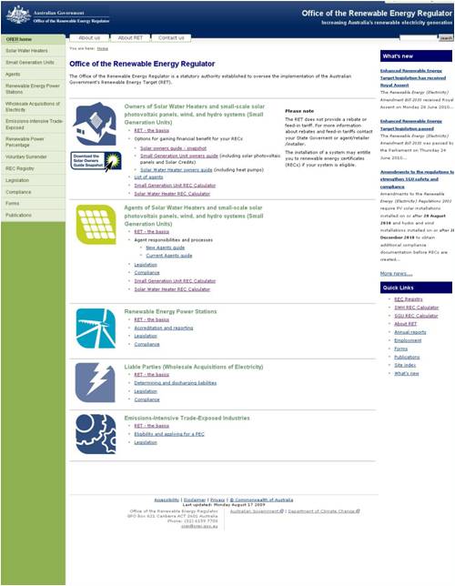

Neil, you're not really helping, can you be more specific? I say this in reference to your comments: [quote]The 'official' fprmula is found on the government page I gave you. Go look again. [/quote] and [quote]Again, see above. Use the lower set of figures on that site. [/quote]
for instance, the only reference to any link you have in your post is: orer.gov.au
Mate I have spent a lot of time ON that page, and it's just as confusing as before.
I have looked at it and tried to comprehend that page, some of the links from that page and then even some of the PDFs from those links form that page. I must not be seeing what you're seeing. Please provide a link to what it is you're talking about.
I don't see any figures or formulas at all :-( In fact the only formula is their calculator which is only part of the equation.
this is what I am seeing:

On the above page, there is a link to Small Generation Units.
http://orer.gov.au/sgu/index.html Click on the RECs tab. Simple.

GREAT LINK! Thanks Neil. I'm actually in the part about doing it yourself, doesn't look too hard (he coughs) ;-)
If anyone can help, if you trade the RECs for the 15 year deeming period you can only do it the once. If you do it every 5 years, you can do it more than 3 times... correct? How many times is the max? 4? or more? Will RECs exist beyond 2020?
Obviously you need the extra certification for the 15 year deeming, but after August everyone needs that anyway (if installed after August, that is)...
When it comes to the deeming period multiplier, the table heading is "Installation date". If you go the 5 year deeming periods, the multiplier extends to the 'date of installation', not the date of the deeming period and hence all deeming period will have the x5 multiplier. Is that correct?
