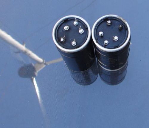

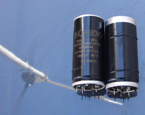

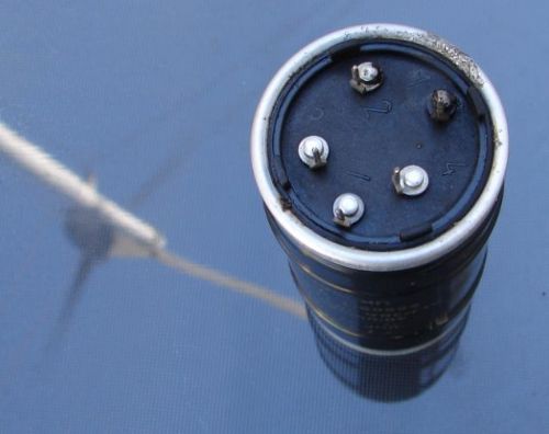

The unit presented with a bang when connected to solar panels, 180VDC only. The unit had no burnt smell, and did not present any shorts. I powered the unit up on a power supply. All good at 160VDC. The unit showed 2 green ligts for ON and PV OK. There was a fault light active and the grid light was OFF. This was still OK as the AC was not connected yet. AC was then connected, and the fault light went OFF and the grid light started to flash. All OK still. As the connection established DC current was only 10mA at 160VDC. Waited the 2 or so minutes and then bang again. Quick disconnection. Assumed switching devices had failed. Major surgery to remove all filters and AC line transformer to see the main PCB. Loosened the main heatsink screws and was able to inspect all PCB components on both sides of the board and measured the switching devices. All 4 devices [not mosfets] measured the same, and no shorts. No visible signs of arcing anywhere. Was not looking good. Decided to remove the main DC bypass filter caps. 5pin plated holes, large thick copper lands. Not an easy feat to remove without damaging the PCB. First cap looked good from the outside, aluminium can with heatshrink intact and all writing clear. On closer inspection found that the mounting pins were deformed and the positive pin was loose. This would not have been good. Decided that the other cap had to come out as well. There was provision for 3 caps on the PCB. The other cap was a bit more stubborn. A bit like pulling teeth. Finally it was out as well. This cap had obviously failed. This was the source of the bang. There was a slight trace of electrolyte under the can, and this had over time accumulated under the cap. The daily cycling of the inverter had allowed the liquid to escape and build up and finally allowed the voltage to track from the positive terminal to the metal can.
here are some pics
The caps are not able to repaired as one pin on the can is loose on both caps.
Decided to replace the 2x 385VDC @ 1000uF with 3x 250VDC @ 680uF. I only intend to connect 180VDC of panels to this unit. I had to insulate the bottom of the caps and work the pins to get them to fit. Reassembly of the internals and time to fire it up again. The unit works a treat now. Very low DC standby current, but the unit consumes 11W from the grid at all times.

Something I find suspect is the plastic sleeving appears to have crept a lot on one cap. These caps look like they or the unit has been running at elevated temperatures.
