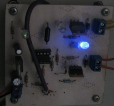

The PICAXE08M controller is working nice but I think is something wrong with my battery. Is discharging fast (in minutes) from 14.4V to 13V having only the controller as consumer. Then, discharging is slowed. With controller on, it will not reach 11V (a limit when consumer is disconnected) all night and morning, when charging is started. Not connected yet a consumer, I have a cold because of the spring wind . But I can see from my bed when LED's go on/off.

You have a 250Ah battery. You appear to have a 7805 reg on the picaxe board. Can you measure the current in the control board? I keep the current in any battery connected cct to <10mA/100Ahr of battery capacity. The voltage from 14.4-13.1 is only surface charge. The capacity will only really diminish as the voltage drops below 13.1V. I try and keep discharge voltage on my 24V system to above 25V. This is approx a 25% depth of discharge. Pb-acid batteries like to be kept charged at close to the float voltage, to achive a long service life. Deep cycling will reduce life. Obviously the battery is really only useful in a RE system if there is some degree of cycling.
I would only worry if the battery spends a lot of the time around 12V. What voltage does the battery drop to over night? When are the relay coils activated?

Well, I need to make some measurements. Yes, is an 7805.
I have an input available on PICAXE so I want to connect a switch for maintenance charging mode. Charging at maximum 12.8V - 13V ...
The only data I have now (acquired before I get a cold) is about time of charging/discharging 13V - 14.4V - 13V
having only controller as consumer.

The current is around 133.5 mA with two LED's (double intensity) and one relay on (maybe I must change the battery on my multimeter ...).

The relay would be the culprit. I design with double throw relays, so I can select NO or NC contacts, to avoid having relays powered unless power consumed would go to a diversion or is excess to battery needs.
