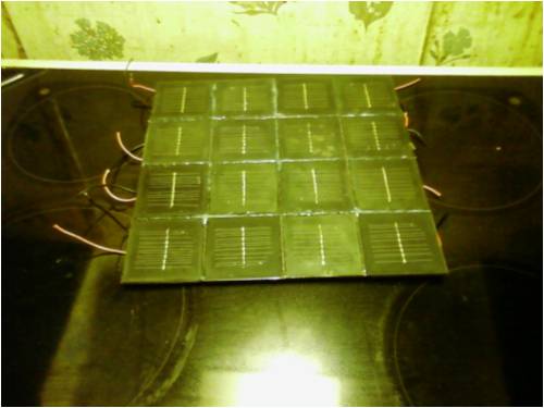

Here are a few of the pics I promised. The first shows the collector part of the cells all glued and stuck together. I am not sure how the hot glue will work, but there are many many options for this iin the future if needed.

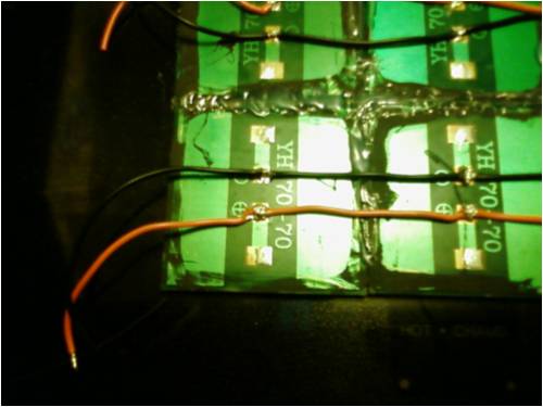

This one is of the back side and you can kind of see how the wiring was done. Looking thru posts it looks as if I am connecting the cells wrong so I will have to try a different arrangement tomorrow. I designed it to be easy to switch if need be. I am running 4 cells in parrallel and connecting each of those groups in series. Looks as if I should do it the other way around from what I have been reading on the forums.

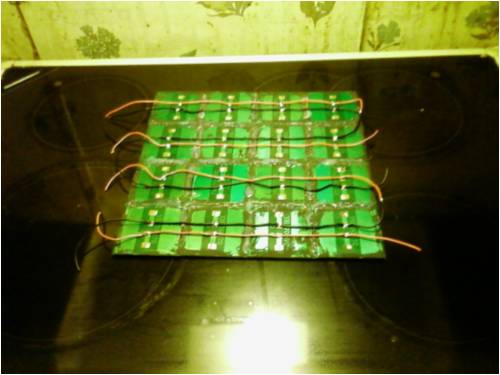

The last one is just a close-up of one of the cells I used in this arrangement. I had 17 of these that were identical and as such this is why this panel is no bigger then this so far.

  Quote  don't have 200 yet LOL that was a typo it should have read 20!
Ah. It's more like making a handkerchief than a shirt then.
No project is complete without hotglue.
I'm not sure if the hotglue will be able to withstand the hot temperature the cells may reach when in full sun. Time will tell, I suppose.
You should be able to get much more current than 90mA I think. The cell I tested yielded 60mA in a short, so should yield about 50mA in normal operating conditions. Putting four of my cells in parallel should yield about 200mA. Your cells look exactly the same as mine.
You may have a few weak cells in there that lower the performance of your entire panel. Especially in PV panels goes that 'a chain is only as strong as its weakest link'. You should test the cells individually for output and select the best ones. That is what Gordon was trying to tell you.
