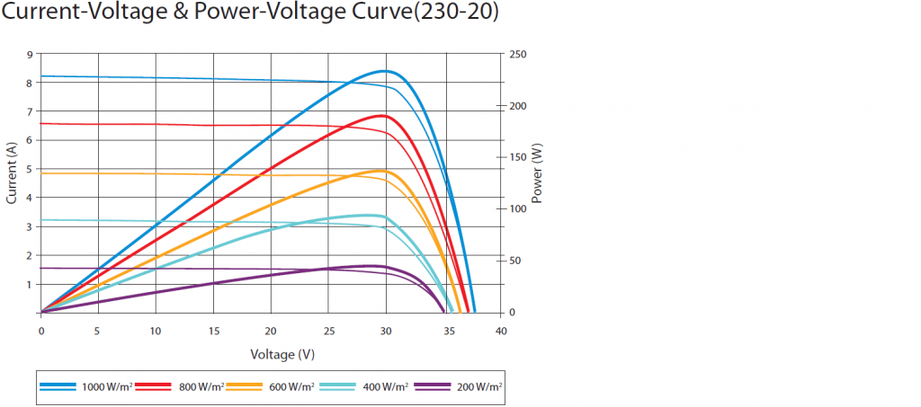

For this particular panel VMP is 30v.
You can see that power falls off far more quickly on the high voltage side.
If you kept within say 26v to 32v it would be crossing back and forth right through the sweet spot.
For eight panels that would be 208v and 256v with VMP at 240v.
A 48v swing sounds like a lot but it really isn't, and that same voltage range would work very well right down to very poor solar conditions.

"For eight panels that would be 208v and 256v with VMP at 240v."
Excellent, seems I am getting this closer than I thought.
I erroneously presumed that the fall off would be worse with sag and the higher voltage would be better but something else learned. It seems the timing and the setup is more effective than I thought.
Thanks for the chart too.  Very useful in understanding how this works.
