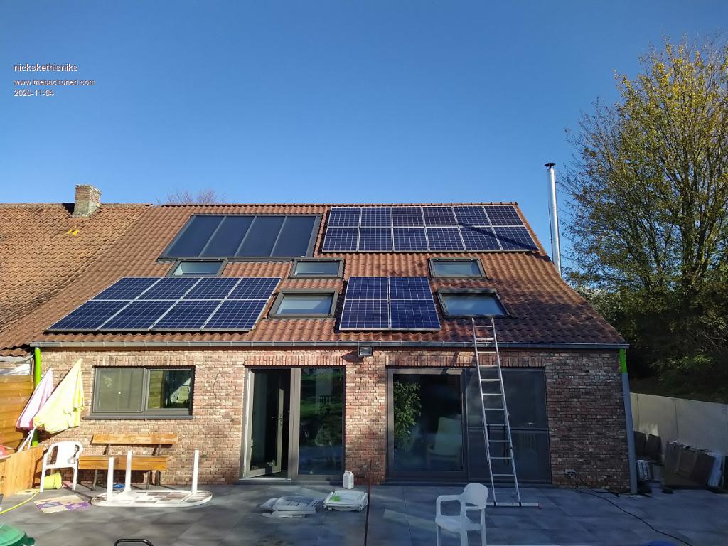

A practical example today @ 11.30:
Pump is running at 5l/min, and in/out is 30/40°C. That's about 3.4kW output.
Outside it is 9°C, clearsky, sun is far from 100% on the panels, you can see at the shading.
A solar panel 280W on the same angle without shading is giving 31V 5A01 --> 155W, 8 panels on the same area would bring me about 1240W.
So you see, the thermal panels are a lot more efficiënt in clear sky, the actual usefull thermal area is 11.1m˛ (Tisun Fi3/4), roof area is 3.01*4.01m.
Offtopic, the group of 4 panels I did yesterday, it took me more than a day to get those installed... Ones my aluminium bars were mounted, I discovered I had 40mm brackets instead of 35mm... So I had to adjust (file,saw,grinding...) them, it took me more than 2h for just that....
Installing solar panels on a roof like ours is a real pain...
I will try to make a new measurement in a few hours.

I didn't come to a new real measurement... I think the max difference was 15°C with 5.5l/min. My solar array on this roof was not doing more then 4000W (6720Wp). One thing I noticed was that the sun is lower when it's pointed straight to the panels. So there is actually not much gain after 12h.
Those 4 extra panels are really adding some kw's in this weather. So the washing machine was on all the time, even the dishwasher and dryer were joining for some time.
