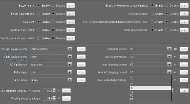

Input Would may be called "Maximum Ac Charge Current" or something different.
However The one I use is pass-through mode and and will use use all the AC to power the hose (total load) and charge the battery at the same time.
If its overloads the generator it will reject it and go to battery, then after a short time it will reconnect to the generator
Yours will be a little different.

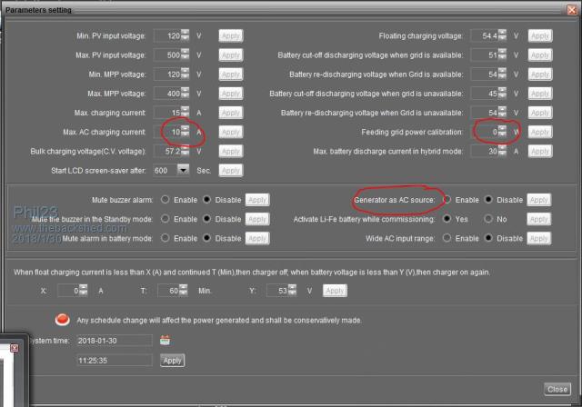

My Parameters page is a bit different.
It's in Off-Grid (II) Mode
AC charge setting doesn't seem to limit what it can pull from the mains either.
"Feeding Grid Power Calibration" is hard to find any decent explanation for, and get the impression it's not related to feeding back to the grid.
"Generator as Source", not real sure about that one either.
Phil.

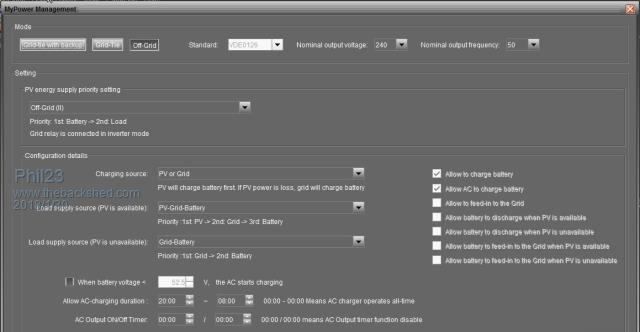

Very watery mention in the software manual.

The AC charge current will be on top of whatever AC loads you have running at the time so keep that in mind with what the generator can produce.

  Madness said   The AC charge current will be on top of whatever AC loads you have running at the time so keep that in mind with what the generator can produce.
Good point. 10A - 500 Watts +.
Shouldn't need it though as the batteries are fully charged before 8:00am.
Unfortunately there seems to be a firmware issue with these where at very low solar levels; about 50 Watts, they seem to draw on the batteries to power their internals, not the grid.
Leads to a bit of unwanted battery drain at dawn & around dusk.
Phil.
Posted: 03:42am 30 Jan 2018
10A = 2400W if it is the AC, can't read those setting pages.

After reading the off-grid section 1-2-3 I can see why its confusing.
Looks like the generator could ether supply the power to run the house direct (not ideal) or work as a DC supply (charger) which would work along with the solar and batteries, should be easier on the genny that way. Not sure, must be the only one that would do this.
